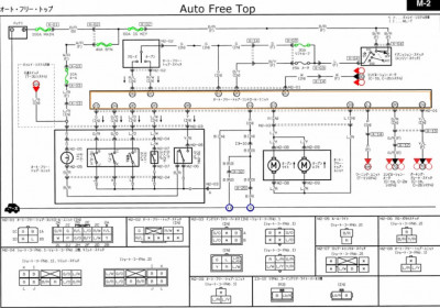

Here is the wiring for the AFT module;

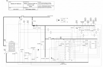

Here is the computer inside it;
Great! Thanks for posting these they will be a good help...once I have fathomed out what is what and try to understand the nomenclature, my japanese is a little rusty these days 😉

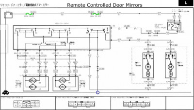

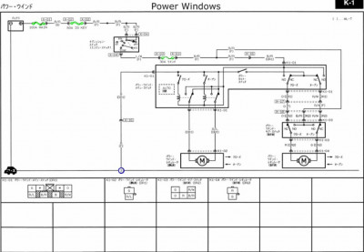

Windows here;
Mirrors here;
You will find little help translating the remaining Japanese all the critical info is already translated!

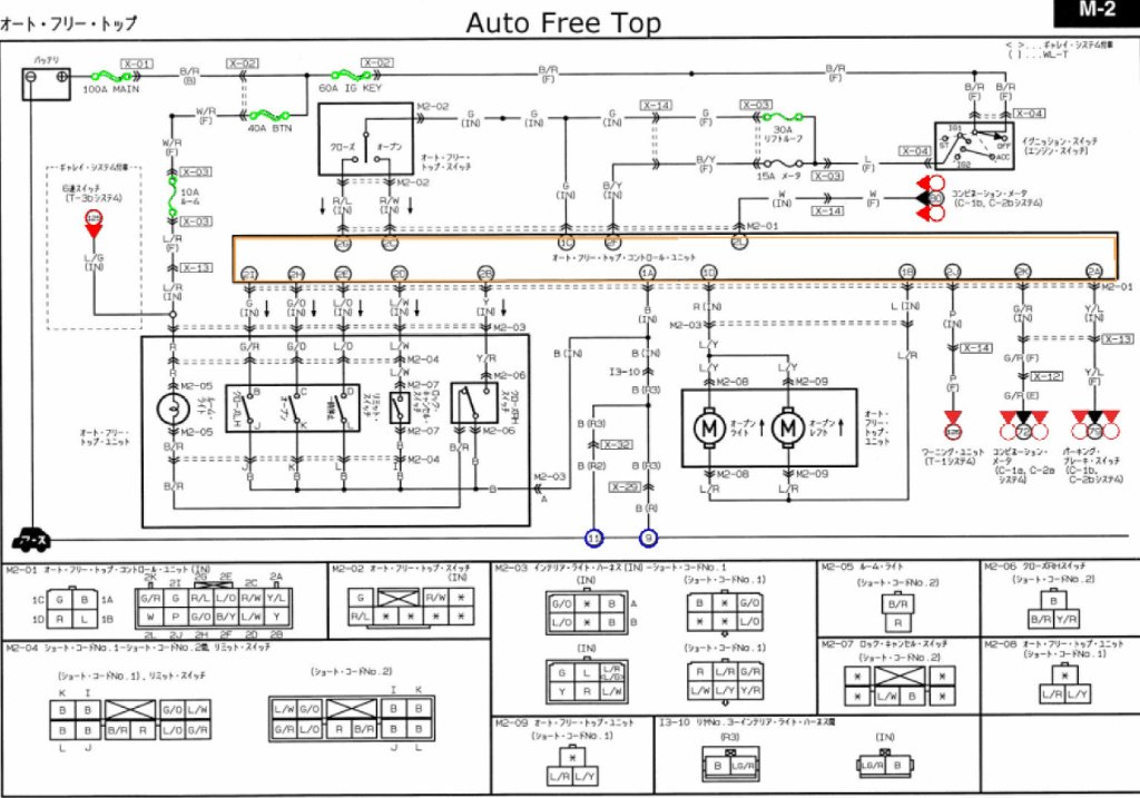

Regarding the roof diagrams, I have now studied them and have an appreciation of what's what, however the colour coding on the diagram doesn't concur with the wiring in the van🥴.
Is there a difference dependant upon year or whether petrol or diesel do you know?
