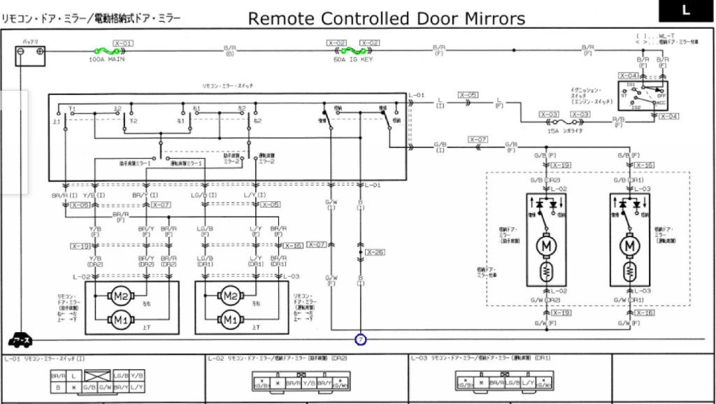

Do you have other wiring diagrams you could share? I could do with the electrical window/mirror wiring as these are not working either....fuses checked.

Re: Login issue
Windows here;
Mirrors here;
You will find little help translating the remaining Japanese all the critical info is already translated!
