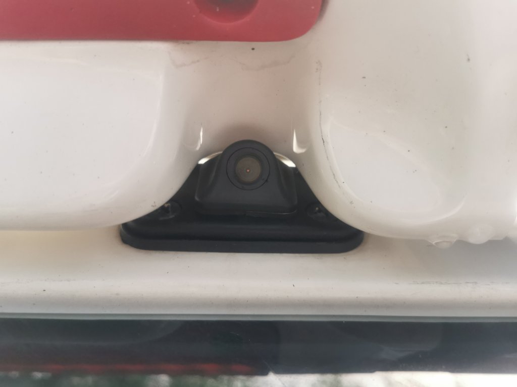

I put one where the mirror was

Really neat fit. =D>

ever after. wrote: Sun Aug 30, 2020 6:02 pm I put one where the mirror was
I really like the idea of installing mine where the reversing camera was and that looks great.
Do you remember which camera you bought? Can I ask how you mounted it?

Brett_Sinclair wrote: Wed Nov 24, 2021 3:50 pm Hi
thanks
Hi Brett,
I can't recall the exact model of camera I used as I didn't buy it new. It's basically just a wedge mount camera that I attached to the mirror mount (I cut the mirror off and ground it down flat to attach the camera)
I remember that cable was a right pain to run, it has to go across the top of the frame and out a rubber grommet on the right, then you have to fish it down the pillar.
Brett_Sinclair
Posts: 23
Joined: Thu Oct 21, 2021 11:40 am
Re: Location for rear cam/ reversing camera
Post by Brett_Sinclair » Thu Nov 25, 2021 10:38 am
That's brilliant thanks, so did you glue it to the mirror mount? Is the viewing angle ok (because I guess these are designed to be fixed under the horizontal surface above the number plate rather than vertically)?

Post by ever after. » Thu Nov 25, 2021 10:59 am
The camera came with some of that double sided 3m tape (similar to what's used on GoPro mounts) and that has held up well so far.
I actually figured it out the hard way about the viewing angle :lol:
I had to disassemble the unit and flip the lens 180°.
You can get really wide angle cameras like 170° which might be more suitable.

Post by Brett_Sinclair » Mon Feb 05, 2024 2:21 pm
It has only taken me a few years to get around to replying, but just in case anyone else is doing the same thing....
in the end I did fit it where the mirror was (as suggested by ever after)
I ended up 3d printing a simple blanking plate to stick the camera on, its here if its of use:
https://www.thingiverse.com/thing:5967890
