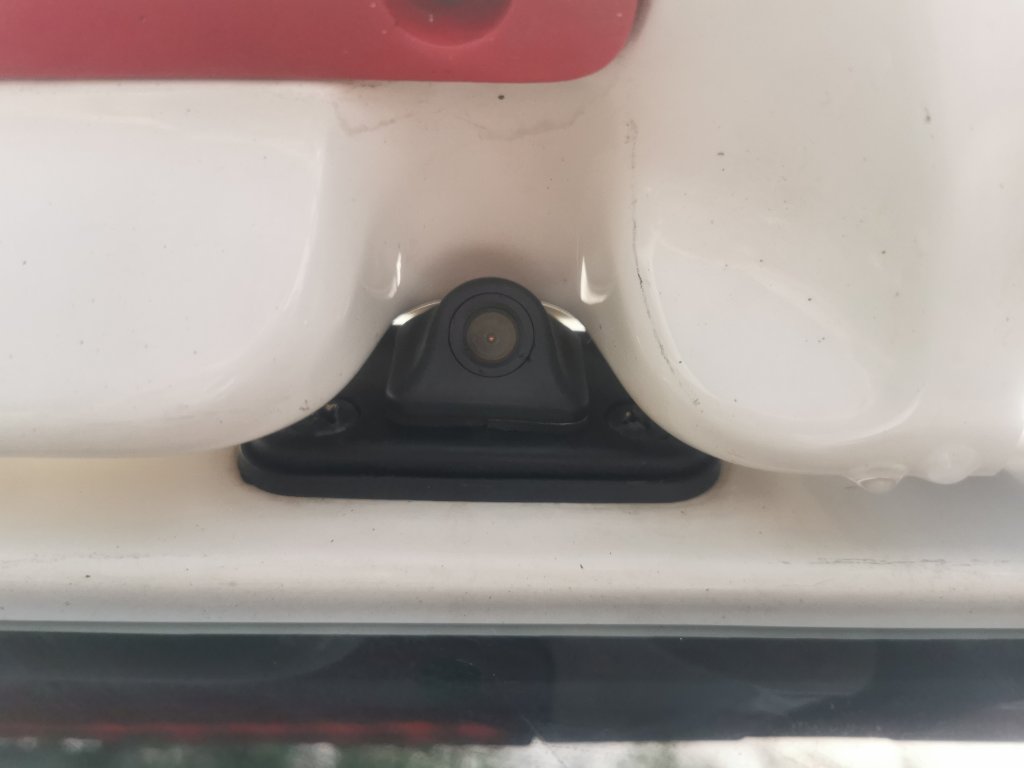

				Brett_Sinclair
- Junior Bongonaut
- Posts: 23
- Joined: Thu Oct 21, 2021 11:40 am
Re: Location for rear cam/ reversing camera
It has only taken me a few years to get around to replying, but just in case anyone else is doing the same thing....
in the end I did fit it where the mirror was (as suggested by ever after)
I ended up 3d printing a simple blanking plate to stick the camera on, its here if its of use:
https://www.thingiverse.com/thing:5967890
