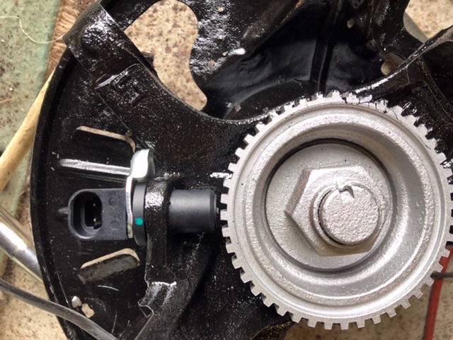

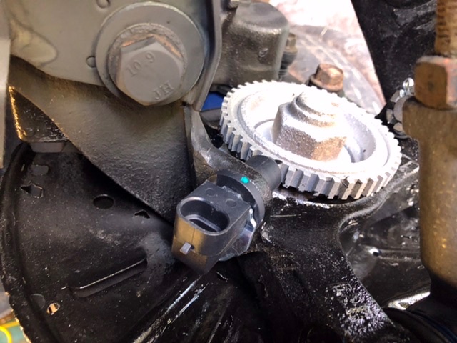

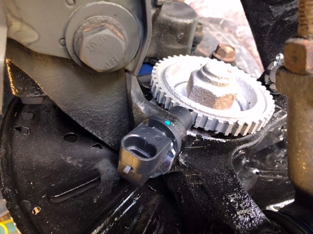

Have sourced an abs sensor which is spot on the cost was £2.75 brand new the mounting bracket rotates so cabn be used both sides just cut into existing wiring and solder on new connector and jobs a good one 👍

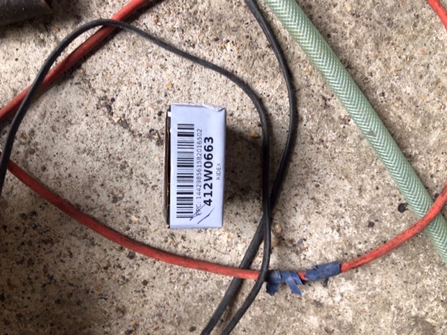

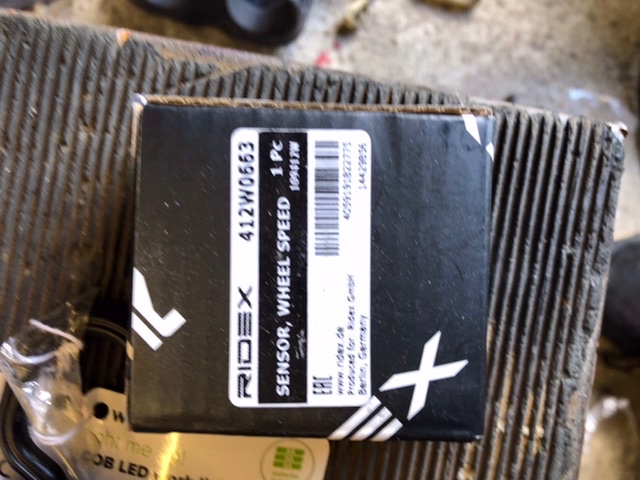

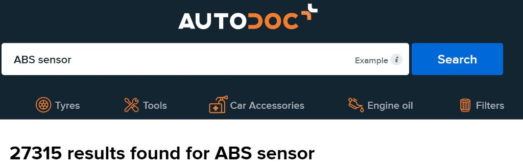

i bought it from autodoc they were £5.80 on ebay and £2.75 from autodoc only downside was they charge £7 for delivery so in hindsight ebay is cheaper ive got some photos of part no on box but they are widely available stupidly enough the connector plugs are about £6 each but sure beats paying almost £200 for a "Bongo" abs sensor for the sake of a little soldering

Posting some photos of part
