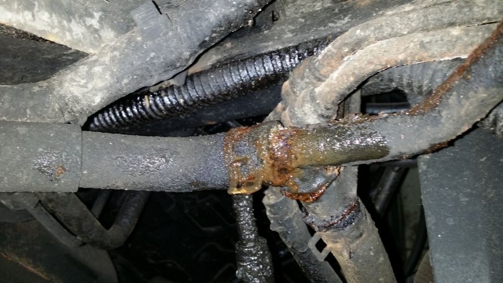

What is this pipe? Coolant leak on 95 Bongo
Post by bodiebongo2 » Mon Apr 06, 2015 8:11 pm
This is a pic of my Bongo, the pic was taken underneath the drivers seat. All of the coolant has leaked out where it looks gunky near the clip. As you can see the pipe has also rusted. Does anyone know what the pipe is and how much it might cost to fix? The breakdown said to fill up the coolant with 4 litres of water and drive to my garage... not sure if this is wise?

Re: What is this pipe? Coolant leak on 95 Bongo
Post by silage » Mon Apr 06, 2015 8:29 pm
don't drive it, get it picked up and taken to a bongo friendly garage.

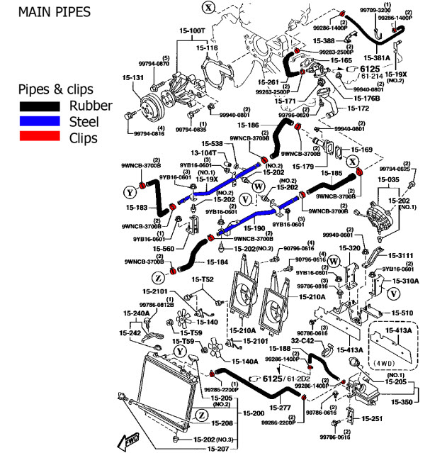

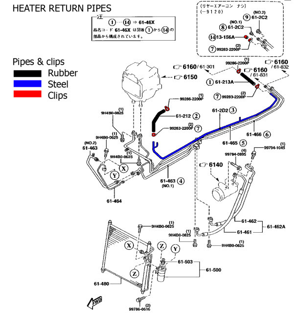

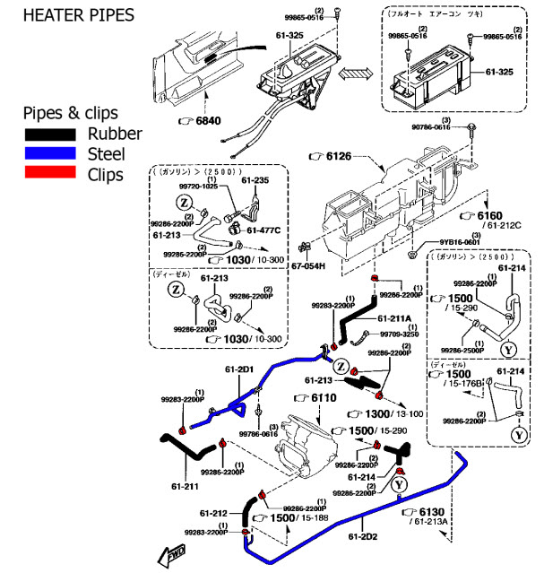

Here are the piping diagrams (I thought these were bookmarked somewhere but can't find them?);

61-2d1 is the pipe thats leaking in geoffs links above.
have a read of this thread it may help.
Post by mikeonb4c » Mon Apr 06, 2015 9:38 pm
bodiebongo2 wrote:Thank you. Looks like a big job then... was supposed to be camping this week...dreading the bill :(
Not necessarily. I opted to have a complete new pipe but my mechanic Adrian usually fixes them by cutting out the bad bit and fitting a t-piece, which is much cheaper on parts and labour (though a system refill and bleed is still required)

Posts: 6027
Post by Ian » Mon Apr 06, 2015 10:11 pm
They are available in the Bongo Shop and are called "Rear Heater Supply Pipe (Driver Side)". Price is £85 including postage and VAT, discount for club members.
