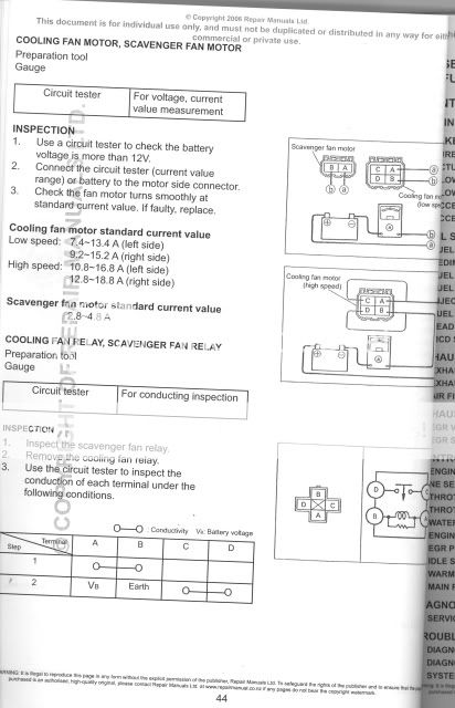

widdowson2008
Posts: 1703
Location: N.E.Derbyshire
Re: main cooling fan
Post by widdowson2008 » Sat Jan 02, 2010 11:35 pm
rita wrote:Hi,that rad and fan is definitely from a later model,probably a sample photo. :wink: :wink: :wink:
This looks like a rad for a transverse engine :wink:
Whats on page 44 ?? :wink: :wink:
Any help?
This page actually suggests 2 fans - left and right (as expected.) So what is the pic of?
Steve
rita
Posts: 3286
Post by rita » Sun Jan 03, 2010 12:02 am
Any help?
Hi,
I don't really know what the the picture is about,(other than a sample photo)and I don't really know why you brought it up.
