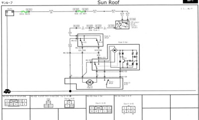

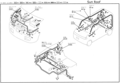

The wiring for a Sunroof is on that date of vehicle;
and locations
