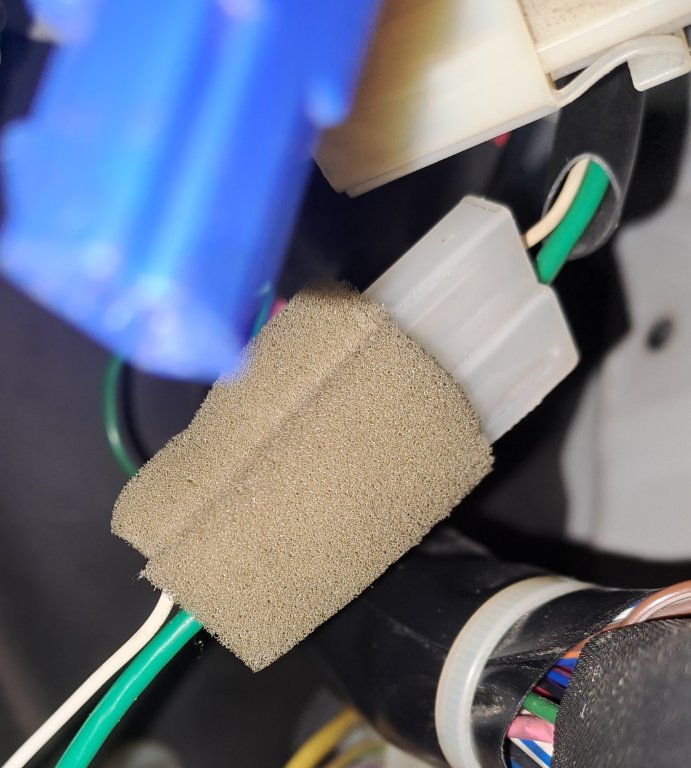

I'm still having issues with roof and some wiring that's been done. Got the wiring diagrams and can follow them, but there is a connector, under the steering wheel carrying from the A pillar a green wire and a white wire. The connector simply is an extension so that the colours follow through. And after that I cannot see where the green wire should go to, even though I know it carries power to the Aft controller. On mine it was shoved into the back of the fuse box in a really nasty way. I have found x13 which also looks like it's been doctored in some way, so I'm hoping for confirmation to that the green wire goes in there.
Any thoughts or pictures? Will upload some pics

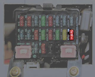

Up is into the A pillar loom. Down?? The white wire I believe goes to the dashboard loom. The blue connector in the picture carries a pink wire which I believe should go to the sound module.
But again, these three wires were just jammed into the back of the fusebox.

Can't see that style of connector with just a Green and a White wire anywhere in the vehicle! Are you sure there is no stripe not visible in the photo to either wire ?

Post by Greenmachine96 » Sat Sep 13, 2025 3:56 pm
Thanks Geoff. I definitely had this wire in my other bongo (recently scrapped). And it has that foam outer. So definitely OEM. The green wire is the thick one in the loom running down the A pillar to power the AFT. There's continuity between it and the green power wire in the roof open/closed switch, so I'm sure it's just the AFT power. But I can't get the roof to power even if I apply power to it directly.

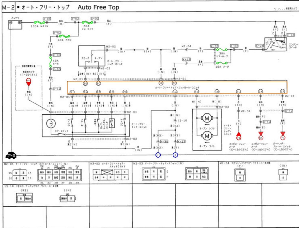

Post by g8dhe » Sat Sep 13, 2025 4:07 pm
Ah yes 1996, I tend to look under 1997+ version!
There is the connector M2-04, they removed it in later versions, its now in the main loom!

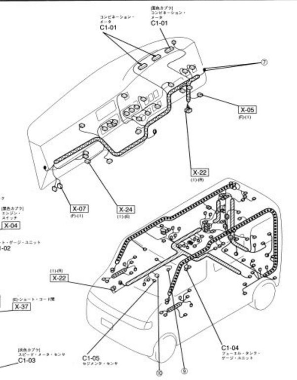

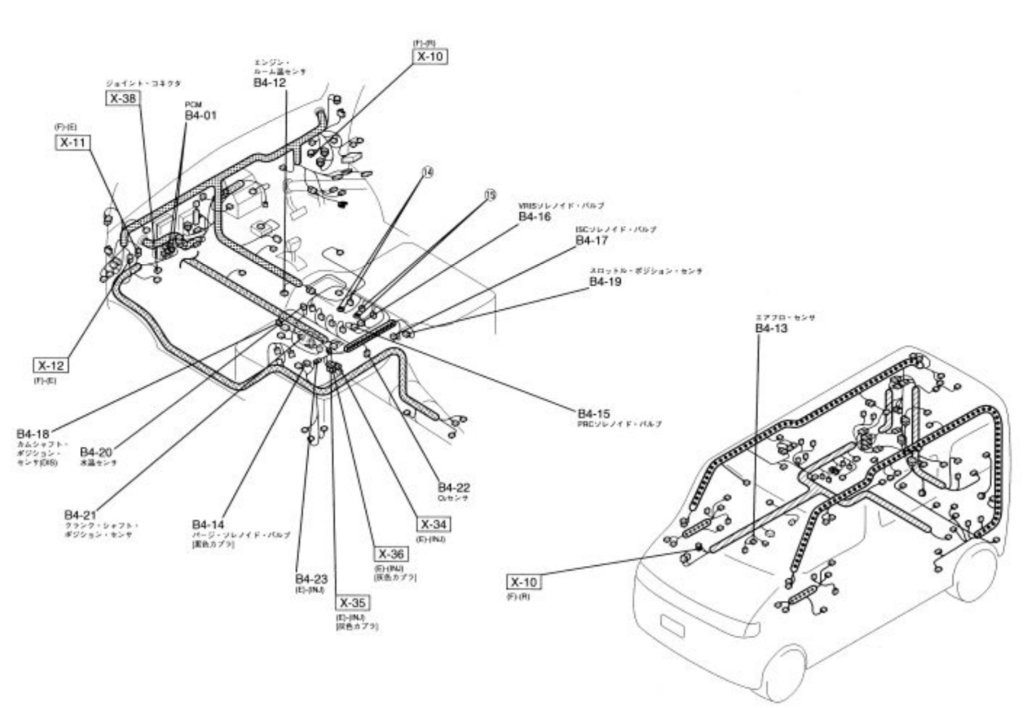

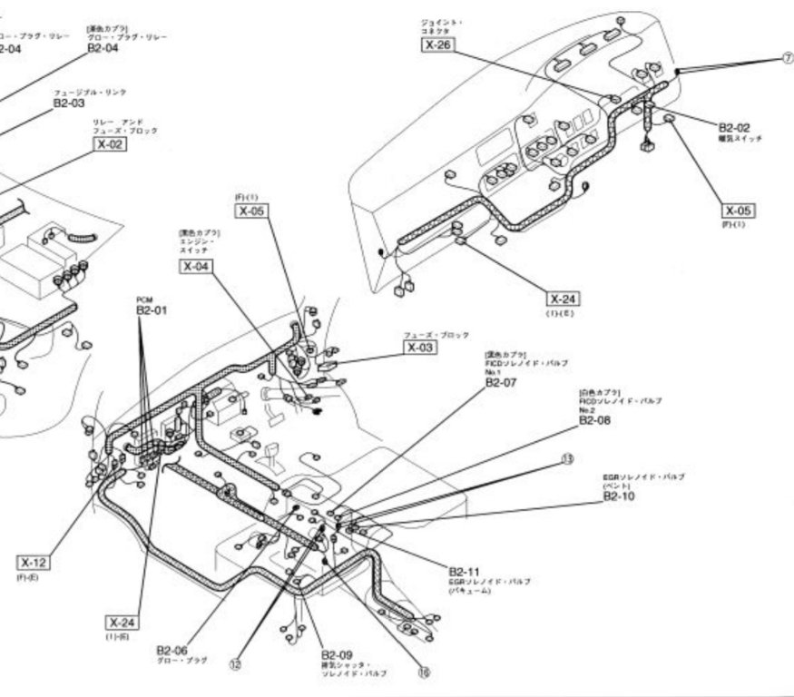

This isn't going well. Every time I try to follow a wire on the diagram, it goes no where. Either to a connector and then not out the other side. Or I just can't match the connectora in the car to the wiring diagrams.
Do we have a photo resource of the X connectors? I can't seem to match them up. I need to identify X10, x22 and X5. But can't find them or they don't have the right colours going to them (according to the diagrams).

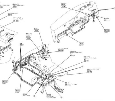

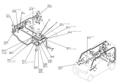

Posts: 10966
Re: Mystery wire
Post by g8dhe » Mon Sep 15, 2025 6:32 pm
Given that your a 96 2.5Td 4 wheel drive - correct ?
Then the images below give the locaations;
X10
X22
X05
