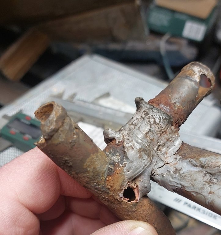

For the sake of interest, here is the rotten pipe that dropped all the coolant, complete with someone's lovely JB Weld bodge and the replacement I fabricated up.
