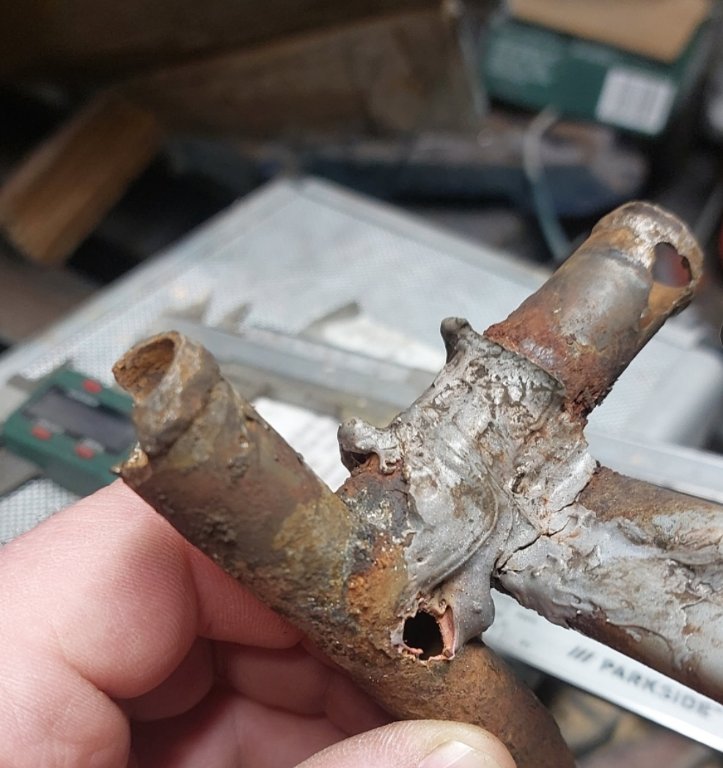

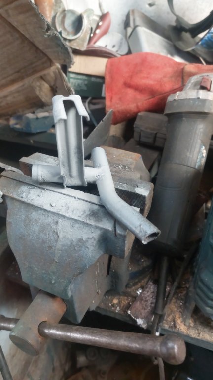

For the sake of interest, here is the rotten pipe that dropped all the coolant, complete with someone's lovely JB Weld bodge and the replacement I fabricated up.

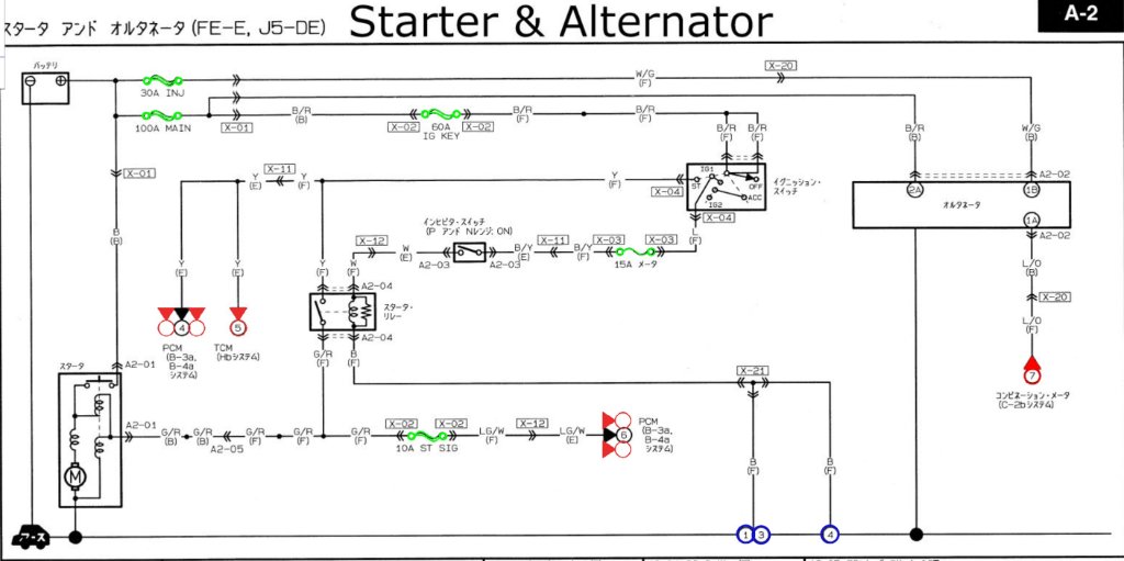

The charge light is controlled directly by the alternator, it provides an earth once the alternator is running and operating see diagram below;
The light is driven from the connection off page far right
Hence it might be worth checking further with the alternator itself.
Re: Charge light on but battery is charging
Thanks,I'll look at the alternator again although I definitely didn't see any loose wires or connectors, unless it's a fault internally to the alternator, in which case, I don't have the expertise to diagnose. It's certainly charging well and regulating the charge voltage as well, it didn't deviate more than a couple of tenths of a volt regardless of the load.

It could be an earthing fault on the wire going to the lamp, or a fault inside the alternator, not able to give much more advice as its a rather simple circuit! +12v - to lamp - to alternator and switching to earth.
I'm guessing it must be a fault internally to the alternator. The wires coming out of the alternator go straight into conduit, so the wire is unlikely to be shorting against the body. The fuel gauge appears not to working either but probably not connected.
