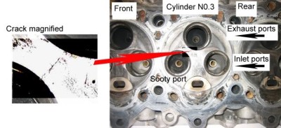

White smoke is normally indicative of coolant in the cylinders as its steam coming out! Possibly a cracked head which is common on the diesel especially between the ports, plenty of searchable details on the forum etc.

Just back from a walk out, where I had a bit of thinking - if it was the cylinder head, surely it would overheat and blast smoke when it was running. I have seen that before and thats when i changed the head last time. At the moment the smoke is just at start up and when it does sometimes burst into life, the coolant level and temp is normal, so that makes me think its not the heads.
