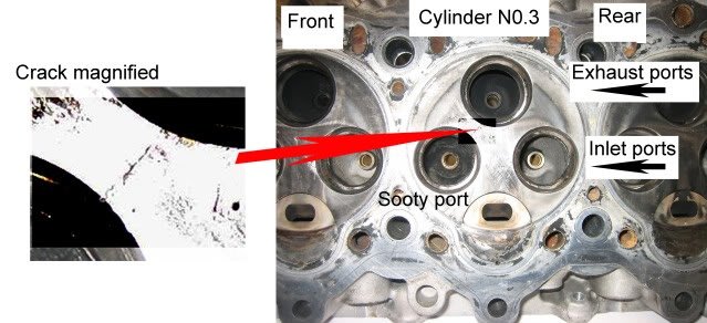

White smoke is normally indicative of coolant in the cylinders as its steam coming out! Possibly a cracked head which is common on the diesel especially between the ports, plenty of searchable details on the forum etc.

There is a big thread which discusses this where Steve cut an engine up to inspect for the problems this link takes you into the middle of the thread were its discussed https://igmaynard.co.uk/bongo/forum/vie ... 78#p456878

Post by alze » Sat May 03, 2025 2:31 pm
Wow ! if anything thats an amazing thread ! I love the engine cut up visuals.
Cheers for the reference, thats really good of you :)
