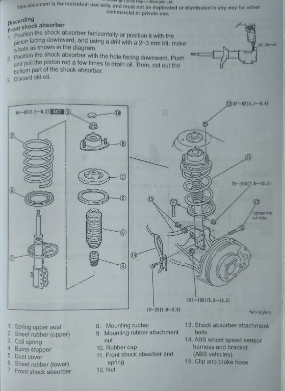

Re: Suspension
See the diagram here not quite sure which bolts your referring too the torque figures are Nm (Kgcm) next to the nut involved.

Re: Suspension
Thats ideal Geoff, I knew they were bloomin tight and no surpise they are over 150nm, the highest I've encountered previously is 140 for the rear axle nut on my motorcycle. Thanks for the prompt replies once again. Hazzo
