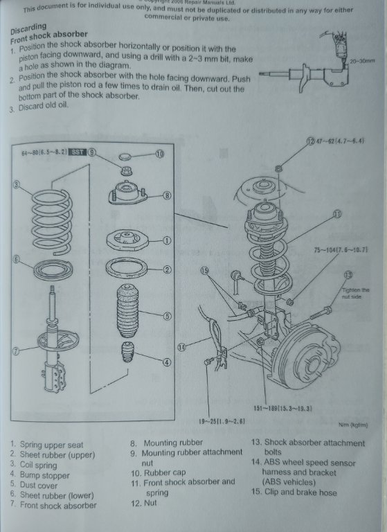

Thanks again Geoff, would you happen to know the torque settings for those two large bolts and the drop links, all of which were ridiculously tight with the drop links easier to cut off with the grinder.
Posts: 10937
Re: Suspension
Post by g8dhe » Wed Aug 07, 2024 8:49 am
See the diagram here not quite sure which bolts your referring too the torque figures are Nm (Kgcm) next to the nut involved.
Hazzobongo
Posts: 187
Re: Suspension
Post by Hazzobongo » Wed Aug 07, 2024 9:27 am
Thats ideal Geoff, I knew they were bloomin tight and no surpise they are over 150nm, the highest I've encountered previously is 140 for the rear axle nut on my motorcycle. Thanks for the prompt replies once again. Hazzo
