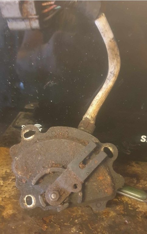

Hiya, so, reconditioned gear box fitted to the van (did not fix it) there's a gear selector piece which fits to the gearbox, that was done on Thursday 26th, so far so good but it's still early days.
That piece has been changed.

so your gear selector was faulty or the actual gear box had issues?
Gavinstjohn
Posts: 8
Joined: Tue May 21, 2024 4:39 pm
Re: Stuck in gear, fans on, no glow plug light.
Post by Gavinstjohn » Mon Sep 30, 2024 8:19 pm
At the moment it's looking like the gear selector.
