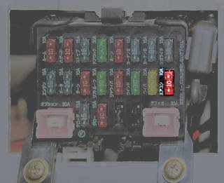

The actual control panels are powered by this fuse
The front fan, rear fan and compressor clutch are all in the fuse panel Ian mentions above.
