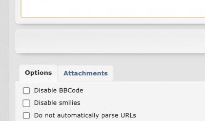

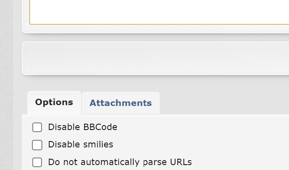

How do you upload a picture to this chat thread?
Re: Fitting a diesel heater and low coolant alarm

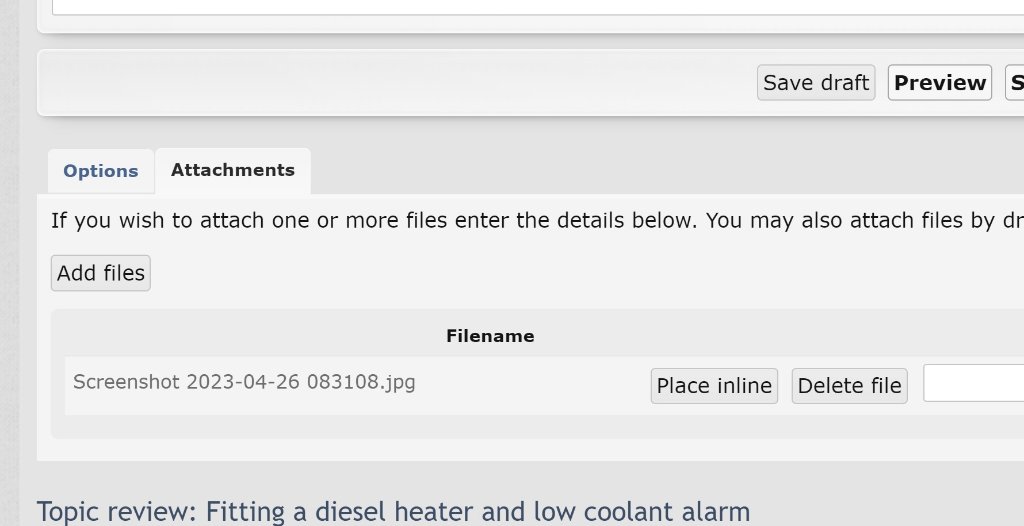

If you want to add images then look down below the text input area and you will see "Options" and "Attachments" Take attachments and then
"Add Files" select the image and choose "Place inline".

Picture.... hopefully ....can't find the. Place in line tab!?

Any clues on adding a picture....it says it's 2.1MB does that affect anything?

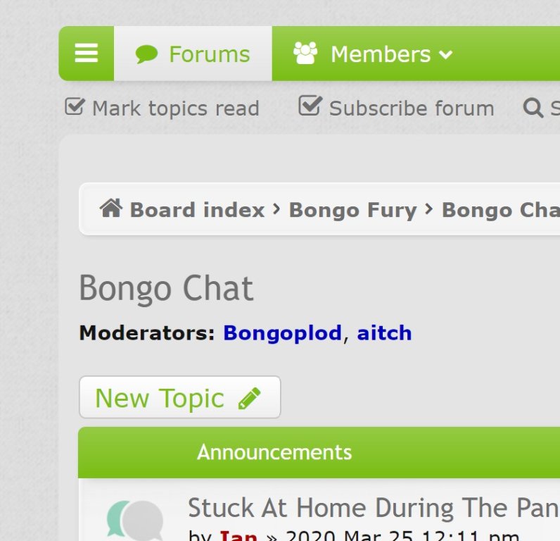

Also I don't know how to put a new post up on the forum.
To add a picture;
Open a reply, below the input area Click "Attachments", Click "Add files" from your machine/network, click "Place inline" the code will appear in the input area. Click Preview and you can see what the post looks like before continuing the text or more pictures.
To start a new post, go to the relevant forum;
Click "New topic" and fill in the heading, then fill in the text area with text and whatever else is needed.Geoff
