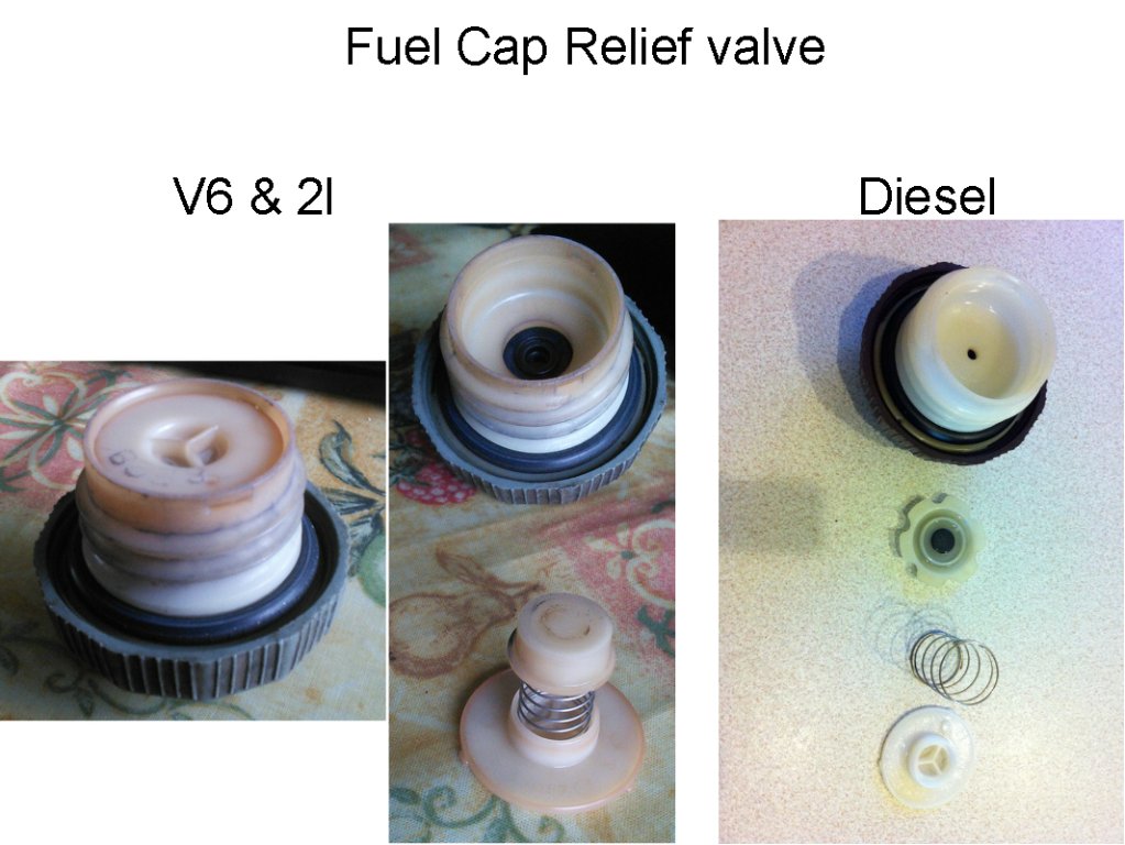

Can you confirm which engine ?
A common cause for all engines is a blocked fuel cap vent, if you take the cap off and pull apart the spring loaded vent and give it a clean it may be the problem the caps are similar to below;

It's a V6 2.5L Petrol. I do have an LPG conversion and the problem is consistent on both fuels. Not sure if that rules out the fuel cap hypothesis?

In that case I would assume it does rule it out ;-)
I'm not a mechanic but would myself take a look at other common things, air filter and ignition system as its a V6 check the spark plug wells for oil gathering in them from a loose cylinder head bolt(s) or a leaking gasket.
