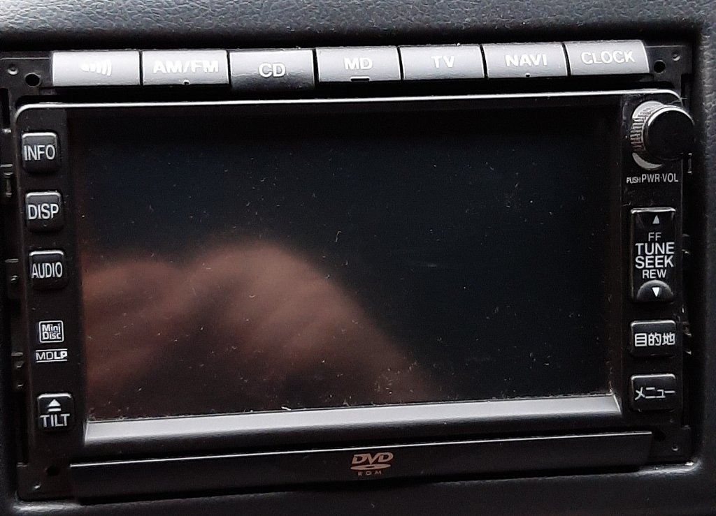

Hi all,
So ive finally decided its time to change out the Japanese stereo for something that will give me more than R2 :lol:
So, i've got the two plastic side panel parts off but dont really see any obvious places you'd slide removal keys into, or in my case a selection of thin screw drivers.
Can anyone point me in the right direction?

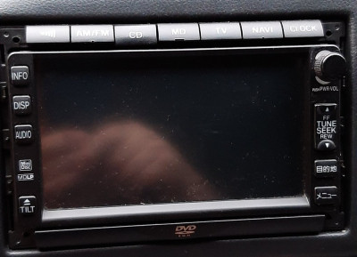

Oh and heres a pic of the unit i have if thats any help at all...

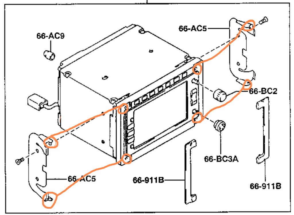

The mech diagrams show the normal spring clips top and bottom each side http://www.lushprojects.com/bongopartsm ... 1of03.html

g8dhe wrote: Thu Sep 15, 2022 8:56 am The mech diagrams show the normal spring clips top and bottom each side http://www.lushprojects.com/bongopartsm ... 1of03.html
Thanks for that, gives a good view of whats there. So do you think I need to actually remove those side plates, or is there meant to be some way for me to unclip them to release it?

No use a release tool or small screwdrivers to press the spring bits in top and bottom each side parts 66-AC5.
