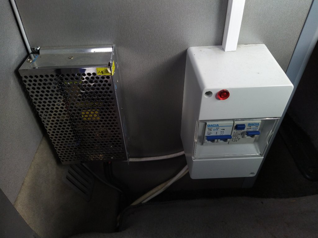

These are the two boxes behind the driver's seat, the one on the left has a constant green light illuminated.

Yes the one on the left is a 12 volt supply for running and charging the 12 volt battery.
If the Fridge is running from 12 volts and only from the battery then it sounds like either a connection from the supply or the supply itself has failed, you will really need to have a check around with a voltmeter to see what is going on.
