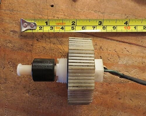

Yes its on the bottom of the fuel (diesel) filter, it is a large threaded white plastic item with a wire connecting to the middle of it see picture below;
Pull the sensor wire off, unscrew and the waste water will drain out, replace the the sensor and replace the wire.

Once I knew they hinged back the rest was fairly easy, used an old 100 pack CD-ROM container tub to catch it all in before transferring it to something more sensible, though you have to wonder how much is water when it's so yellow with diesel.
Now, do we take it to any normal waste disposal place to get rid of it, or how to dispose of it?
