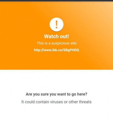

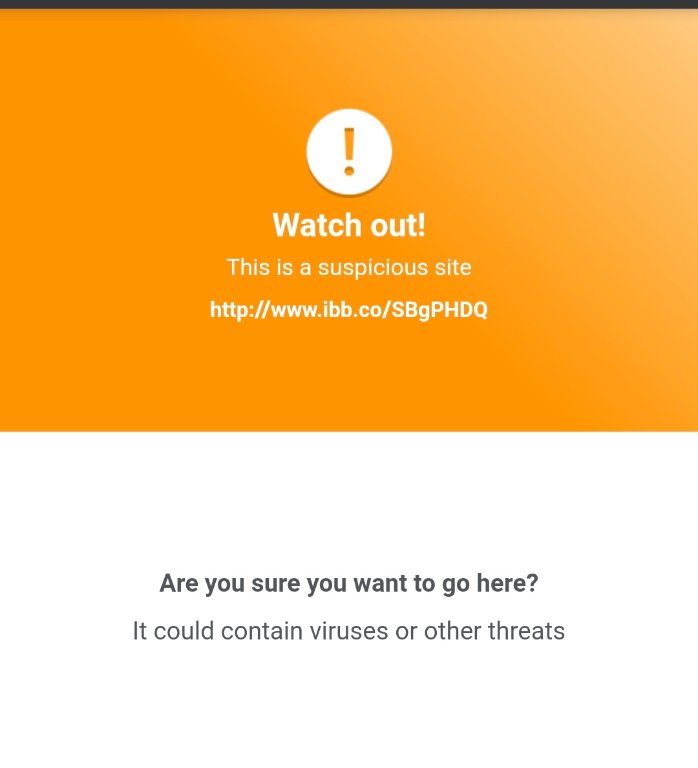

Hi Bongomad. Your photos won't show as it says the site your links go to, is suspicious. The site may be ok, but it sill makes it difficult to see your photos. So your links have been edited.

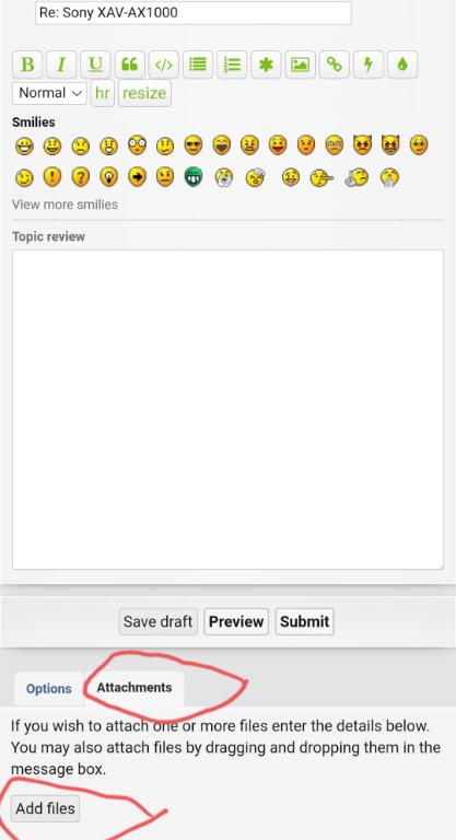

To add a photo, click on 'Attachments' then 'Add files'.

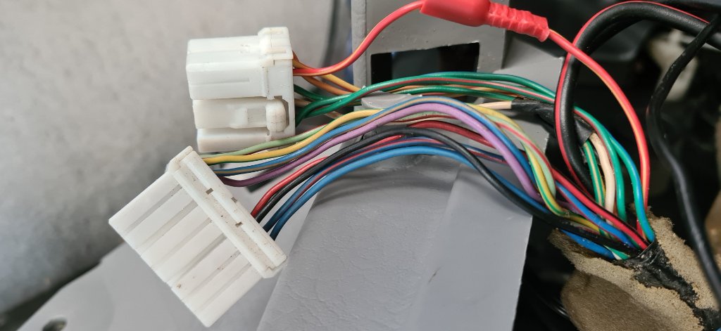

The Red/Yellow wire in the audio loom is the reverse light wire, that will tell the stereo you are in reverse.

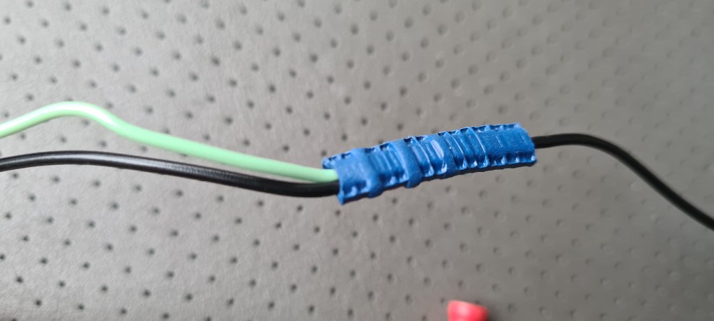

Brilliant thanks. I’m away for weekend so will have a look Monday. There’s a green parking brake cable coming off the new unit. I’ve read about people just grounding this to the unit cage. 🤔

I just joined the green handbrake wire to the earth wire otherwise I couldn't use sat nav without handbrake on #-o
