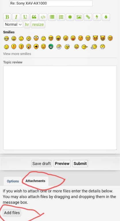

Hi Bongomad. Your photos won't show as it says the site your links go to, is suspicious. The site may be ok, but it sill makes it difficult to see your photos. So your links have been edited.
To add a photo, click on 'Attachments' then 'Add files'.

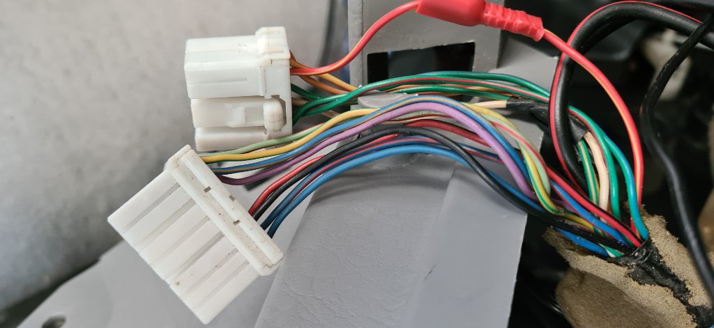

The Red/Yellow wire in the audio loom is the reverse light wire, that will tell the stereo you are in reverse.
For some reason I can't upload a picture
Error
The image must be at least 0 pixels wide, 0 pixels high and at most 1024 pixels wide and 768 pixels high. The submitted image is 461 pixels wide and 1024 pixels high.
It seems if I rotate the picture in my phone gallery I can
Error

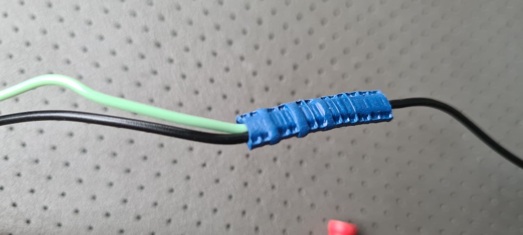

Brilliant thanks. I’m away for weekend so will have a look Monday. There’s a green parking brake cable coming off the new unit. I’ve read about people just grounding this to the unit cage.Winnie-bongo wrote: Fri Jul 16, 2021 11:04 am The Red/Yellow wire in the audio loom is the reverse light wire, that will tell the stereo you are in reverse.

I just joined the green handbrake wire to the earth wire otherwise I couldn't use sat nav without handbrake on
