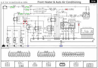

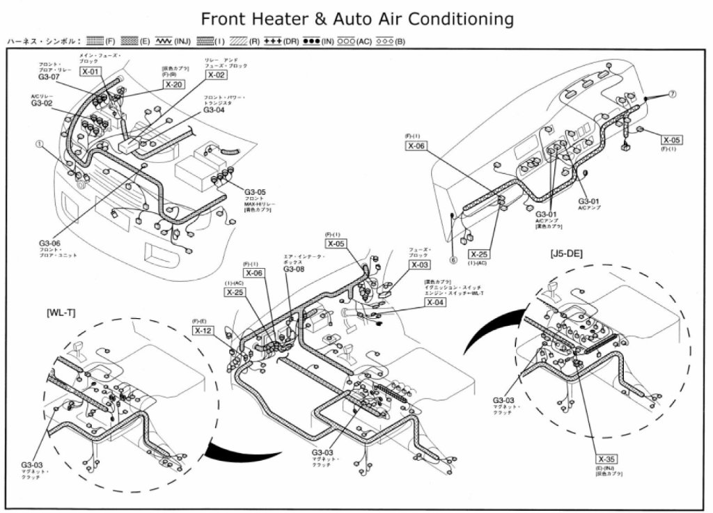

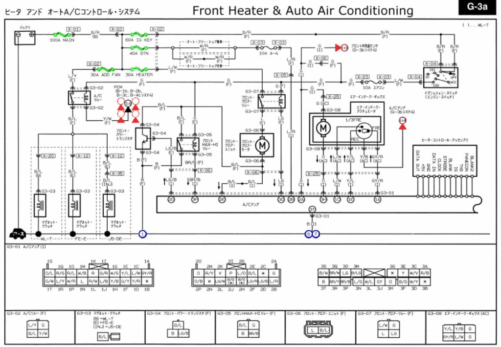

Is there a relay for the clutch on the air con compressor
Posts: 10951
Re: Air con relay
Post by g8dhe » Tue May 11, 2021 9:48 pm
Yes! circuit and location diagrams below G3-02 is the relay top left hand side;
willow2u
Posts: 199
Re: Air con relay
Post by willow2u » Tue May 11, 2021 11:12 pm
Cheers for that I’ve looked at that diagram for ages and knew there was one now I see 👍
