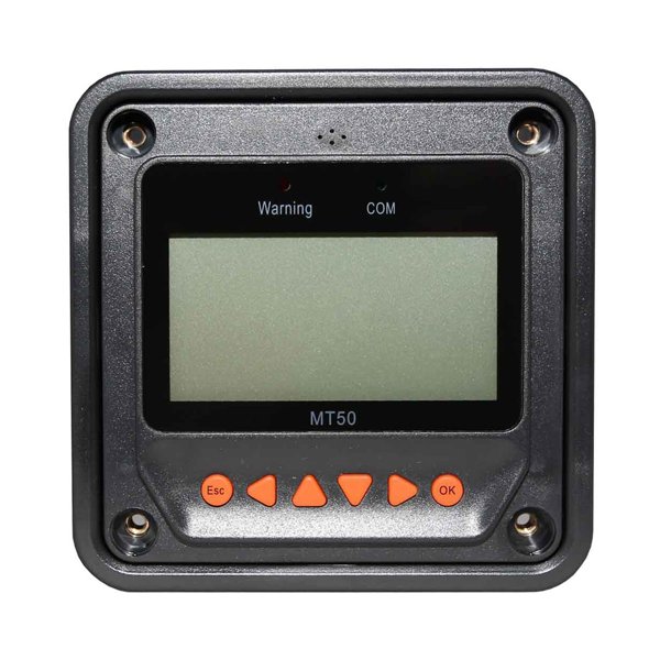

Post by g8dhe » Thu Mar 25, 2021 11:30 pm
Most of the controllers will show this on there displays, either on different tabs or on the diagram on the MT50 display panel;

Mine's the Tracer1215BN. There's no display on it. The low cost one does have a display and changeable settings though.
I do have a cable to connect the Epever Tracer to my laptop to see what's happening. My knowledge runs out on what some of it means though. I'll see if I can plug it in later and get something meaningful that'll help.
