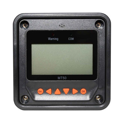

Most of the controllers will show this on there displays, either on different tabs or on the diagram on the MT50 display panel;
Re: Solar panel - expecting too much?
Mine's the Tracer1215BN. There's no display on it. The low cost one does have a display and changeable settings though.
