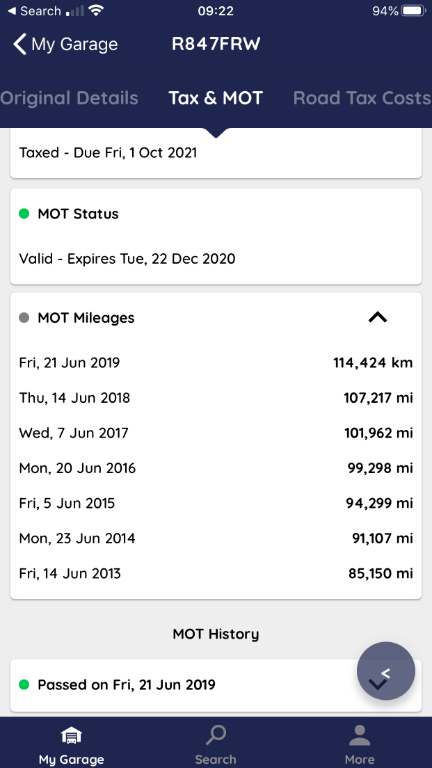

Both my Bongo’s read & count in KM’s but all the MOT history shows this as Miles! It was only on my last MOT that they actually put down KM’s (Picture Attached...)
You can check the MOT mileage history with the likes of “My Car Check” App...
My ‘98 has 119,000 KM with standard clocks so speedo only has KM’s & my ‘02 has 211,000 KM with MPH & KMH Speedo but ODO still counts KM’s.
If reading in Miles now then you could work out when it was imported & what the MOT mileage was then...
That would be KM’s & from there on would be miles...
