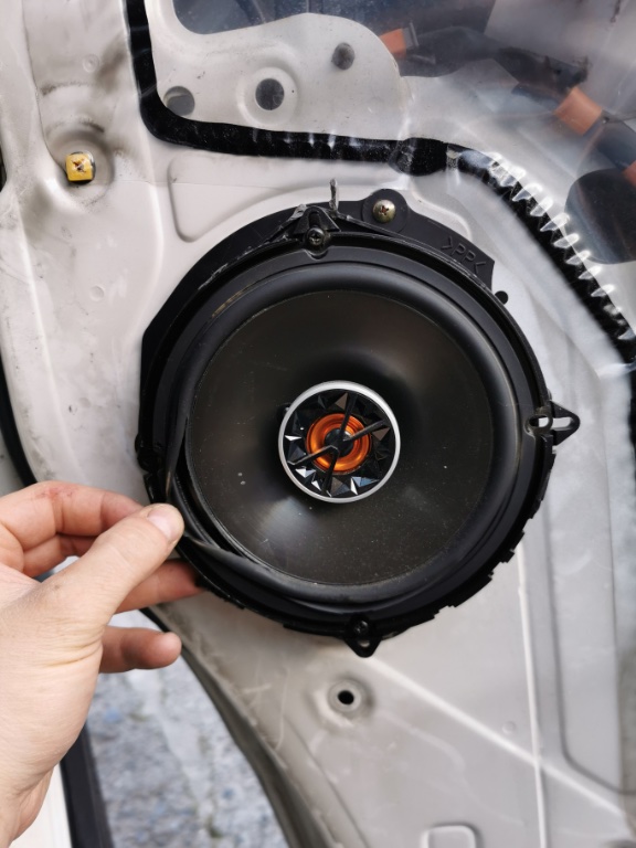

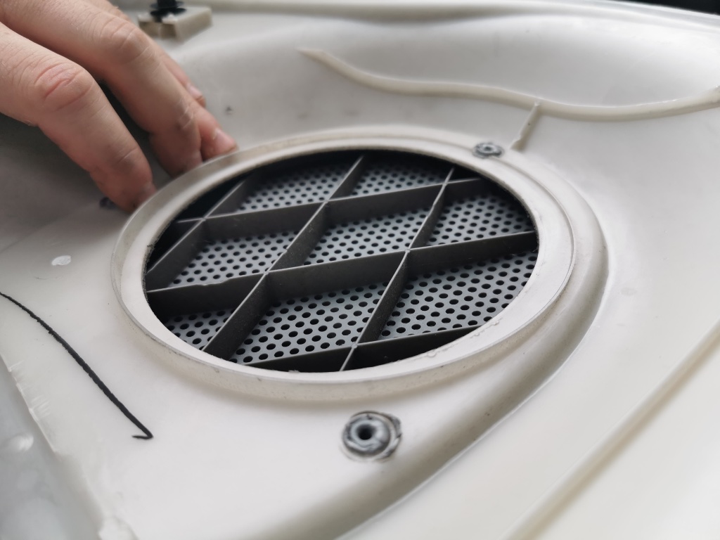

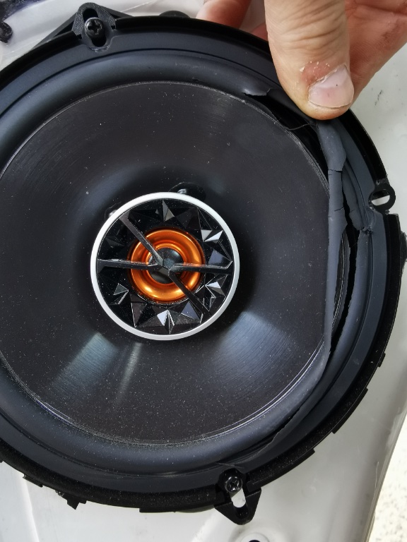

I redone mine last week after upgrading everything 3 years ago.
I blew both of my front door speakers and both were broken in similar places :-k

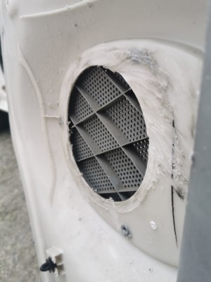

I had my suspicions that it may have been caused by a plastic ring that protrudes out on the inside of the door card?
Seems I can only add 3 pics to a post so I'll have to make a few posts :-o

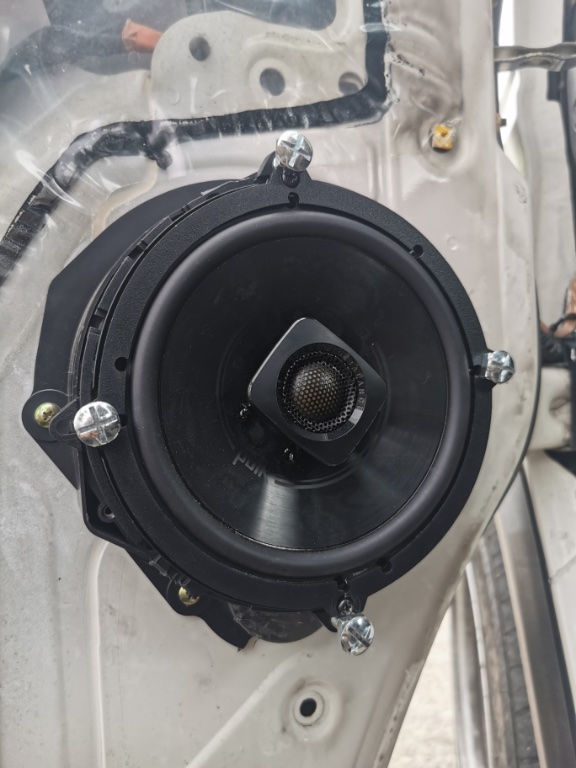

I ground off the plastic and added gutter bolts to the edges of the speaker mounting plates just incase they were in contact before.

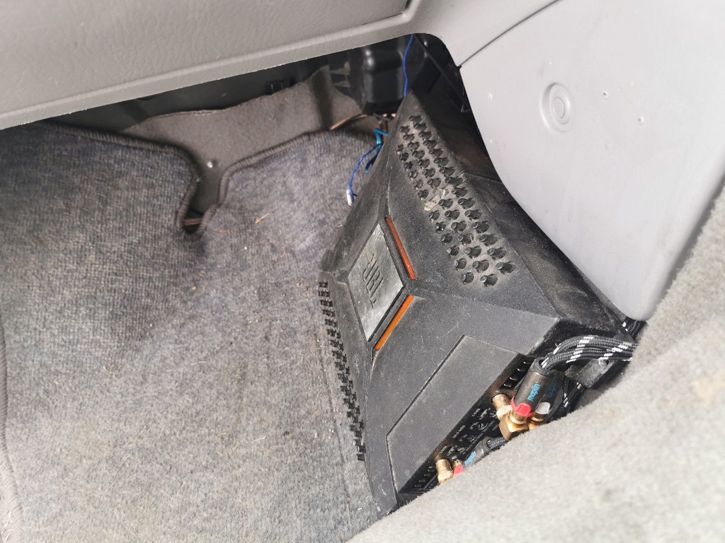

Said I'd update the amp for a newer smaller one while I was at it. I never liked having the amp on display and there wasn't really anywhere suitable to hide it.

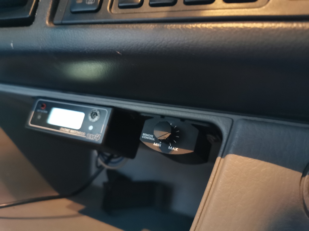

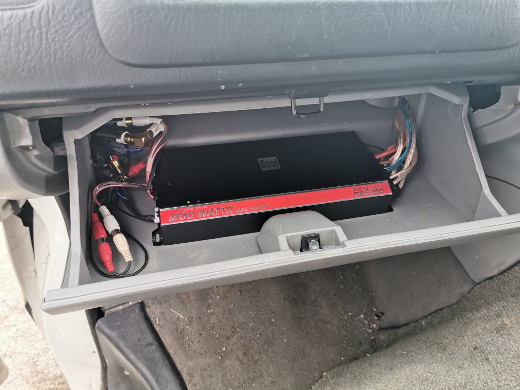

The amp I got is 5 channel so I can power a sub now as well as the front and rear speakers. Came with a bass remote which as it turns out is kinda handy.
Fits in the glovebox, I will need to raise up off the plastic for cooling purposes, I may make a bracket and place it under the glovebox in the future.

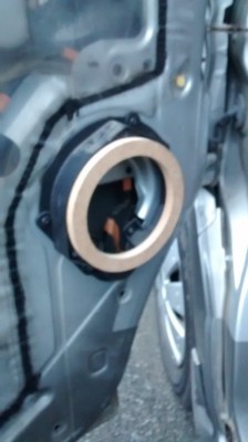

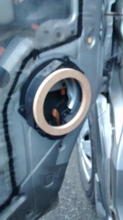

You can get spacers to put in the front doors so that more speakers will fit. Can't remember the size or anything as it was several years ago we did ours.

As far as I remember I removed the stock front speakers from the plastic spacer they were mounted to and reused that along with the mount that came packaged with the speakers.

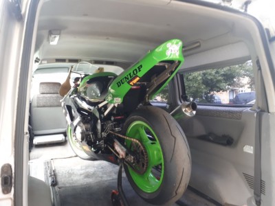

Similar scenario here.
That's mad, I dunno how the hell you fit that in there :shock:

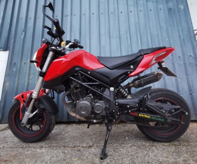

Here's the bike that lives in my bongo :lol:

I'm a 2 hour drive from a track so I don't bother, been meaning to do some track day training alright so that might persuade me into getting a track bike.
Just bike on the roads and this is my little toy bike.
I put on these little pirelli diablo corsa scooter tyres and it's some laugh on the backroads :lol:
Have it taxed and insured too so I can ride it wherever
