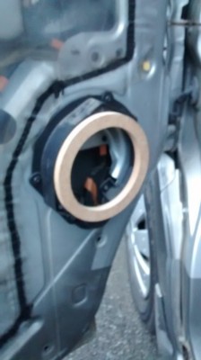

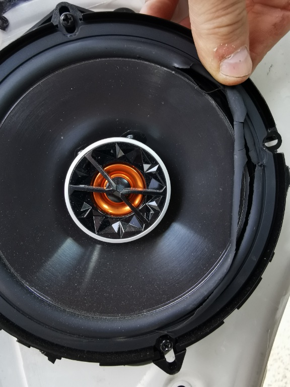

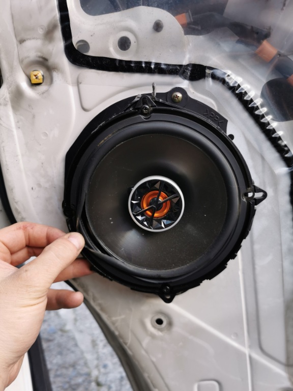

I redone mine last week after upgrading everything 3 years ago.
I blew both of my front door speakers and both were broken in similar places

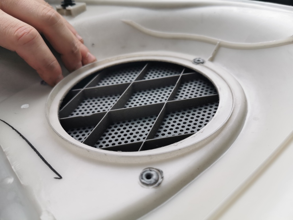

I had my suspicions that it may have been caused by a plastic ring that protrudes out on the inside of the door card?

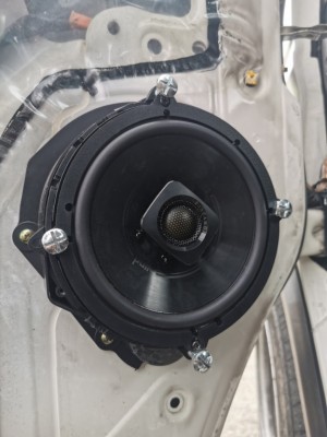

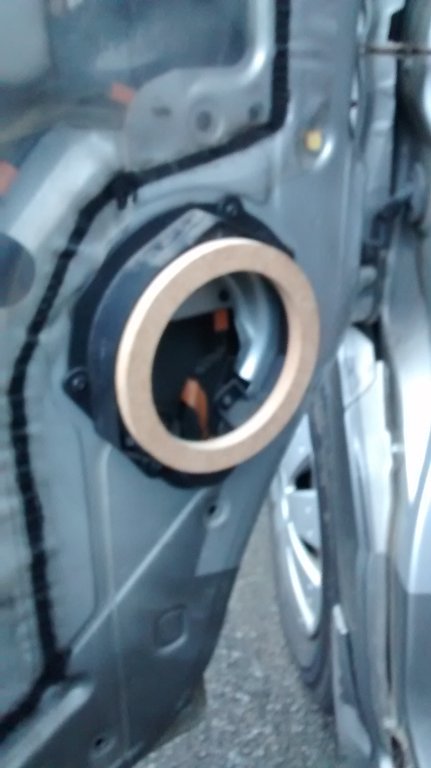

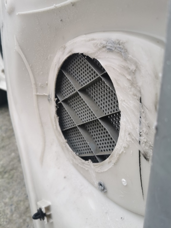

I ground off the plastic and added gutter bolts to the edges of the speaker mounting plates just incase they were in contact before.

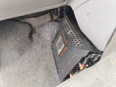

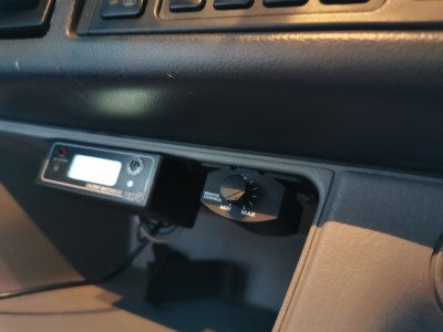

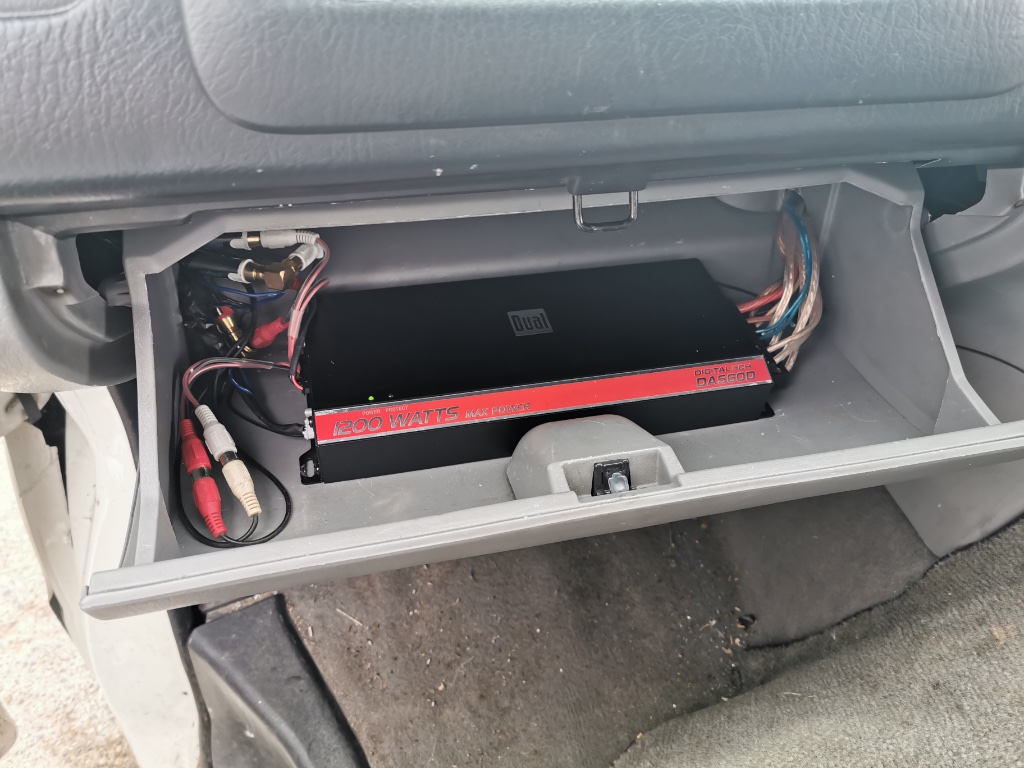

The amp I got is 5 channel so I can power a sub now as well as the front and rear speakers. Came with a bass remote which as it turns out is kinda handy.
Fits in the glovebox, I will need to raise up off the plastic for cooling purposes, I may make a bracket and place it under the glovebox in the future.

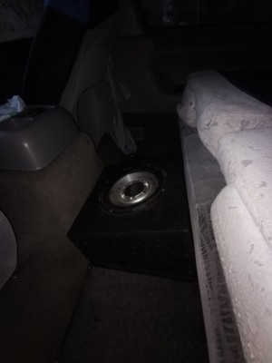

Temporary 10" sub I had in the garage, looking for a shallow mount setup to place under the sliding rear seats.
Overall its a great improvement over the first setup. Also I bought it all second hand so it worked out cheap.
Amp used...

Thankyou for the reply, the sub I've seen is pre amped and the head unit is reasonably powerful so I'm hoping to only need the front and rear speakers I'll be removing the door cards towards the end of the week to have a good look. So the speakers fit without fouling the window mechanism they and the modification you did was to prevent splitting?
Re: Intro and speaker advice
You can get spacers to put in the front doors so that more speakers will fit. Can't remember the size or anything as it was several years ago we did ours.

As far as I remember I removed the stock front speakers from the plastic spacer they were mounted to and reused that along with the mount that came packaged with the speakers.

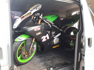

Here's the bike that lives in my bongo
That's mad, I dunno how the hell you fit that in there
Haha that's awesome small world eh I have to use a paddock stand too because its a racebike no sidestand Amazing what a bongo can swdllow. Lovely bike you do you track it too?

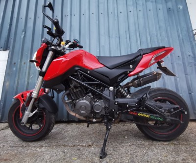

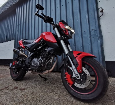

Just bike on the roads and this is my little toy bike.
I put on these little pirelli diablo corsa scooter tyres and it's some laugh on the backroads
Have it taxed and insured too so I can ride it wherever
