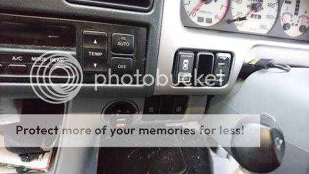

If you have a spare switch blank free then these fit with a tiny little bit of filing.
http://www.ebay.co.uk/itm/12V-24V-Dual- ... SwnHZYfyRN

It wasn't entirely my idea but they are a pretty neat solution.
Mine had a blue LED next to both ports which was a bit bright and unnecessary, the casing pried apart quite easily and I just snipped the LEDs off.
