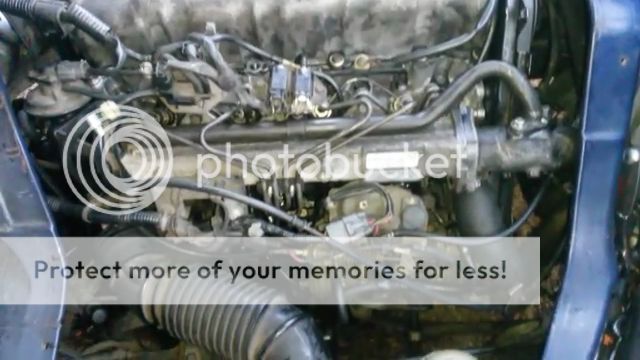

Evening all, kind of dissaperared for a while as crazy busy at work. Dti all set up and still metalic knocking. Thinking piston slap or small ends.using the ext stethoscope i can hear something going on inside. Head off tomorrow i think and give the pistons a wobble before dropping the bottom end.any other suggestions on video?

Notice the delay between me accelerating and the engine revving.the smoke is easystart in the turbo.

is all ok at the top end rockers all set up right, all moving ok when you manually rotate the engine.
ive seen them run, but badly, like this with a broken cam.

I haven't actually removed the cam yet. That will be my next job! I have just striped the injectors as they were leaking. Cleaned up and reassembled. Re-clocked the fuel pump and still hard to start. White smoke and hard to rev. Oh checked egr also and all free moving.

I noticed on your Vid that No1 injector was blowing. I would advise you to get a experienced Diesel Mechanic to have a look and listen to your engine, it will probably be more cost effective in the long run rather than guessing and fitting unrequired expensive parts.

Yes it was.that's why I'm striped them today and sorted all leaks now. One last hit tomorrow where I'm going to take the head off to look for damage.of there is none then none then the engine is getting dropped!

Piston slap! !! Took head off and number 1 piston is all over the shop. Wasted bloody ages on this engine. Oh well. New engine for me!
