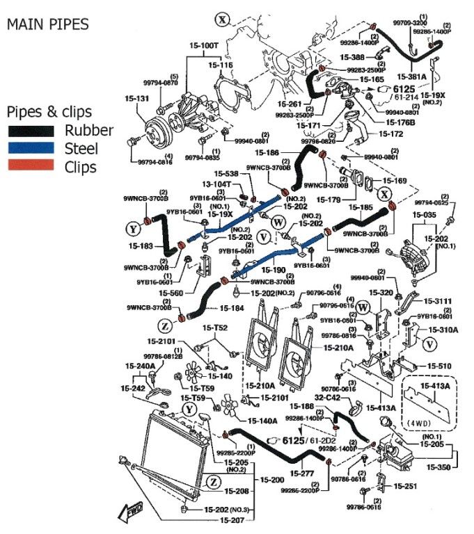

Thermostat is 15-171, you'll see the housing under the passenger seat at the front of the engine. But when you dismantle the housing you'll have to bleed the system again

Thanks, so no easy way to check if the thermostat is there then..
do we know where the temp sensor is? I noticed a sensor on the drivers side, so assume that is it?

No, not without dismantling the thermostat housing although that's only two bolts. As soon as you disturb it, coolant will hiss everywhere and you'll have allowed air into it so you'll have to bleed it properly.
