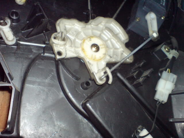

look down by the drivers left foot there is a white disk which turns and controles the air flow
1 of the tabs has brocken off yours and a wire has come loose
I bet thats the problem

Yup picture below of the parts;

Are these available as a spare part, mines been broken for ages and only stops working every month or so and I just pop the rod back into place, but would be nice to have it working
Or are there any fixes to solve a broken one ?

I wired mine in place with some fine steel wire, I wasn't expecting it to last long but it has. You obviously have to leave enough slack for it to move. The rod itself I made out of a straightened out paint kettle handle. Getting the length right took a couple of goes but it works fine now. (This is on the electronic control one,)
