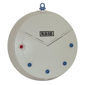

I recently bought a cheap alarm -- as a temporary measure for a new bongo -- which goes off if you move it (annoyingly only a 3 second grace period on it). Ideally I want it to be outside so it's nice and loud when it goes off, but hidden, and easily accessible.It's about the size of a small saucer http://www.amazon.co.uk/Kasp-610-Portab ... B002JCTR0G
Can't go under the bonnet, because that'll be too much of a faff...and not in the wheel arches because it won't be weatherproof. Any ideas, or do i just give up and anchor it under the dashboard inside (which won't be much use if the thieves are using a low loader and don't need to break in)?

In the Belly pan so you can just reach in to arm/disarm it.

looks like a smoke alarm with a shock sensor in it why not get one of these you will have remote locking also
