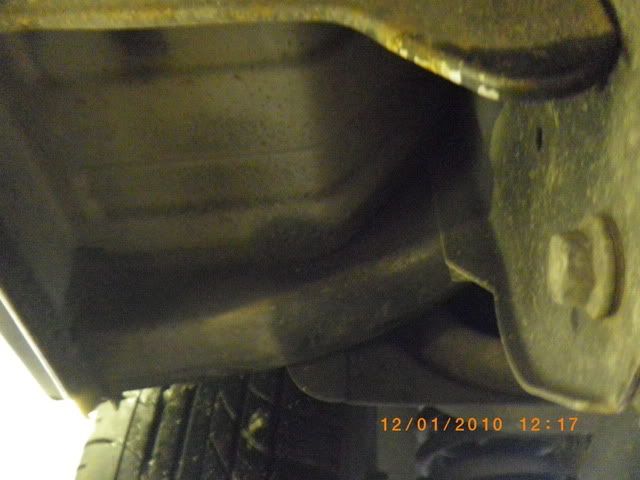

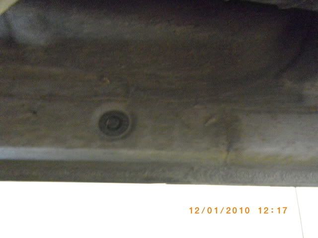

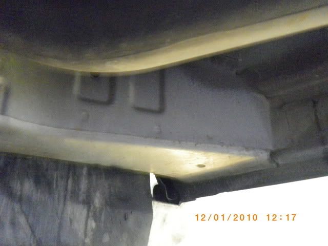

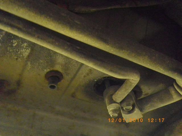

Well, it appears from an inspection on the ramp that the wax oil hasn't been done.
I have attached some photos for freda's underside :oops:
