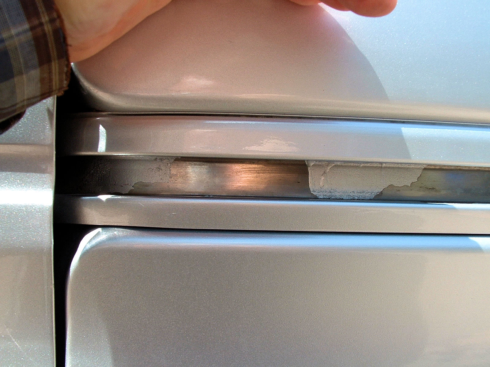

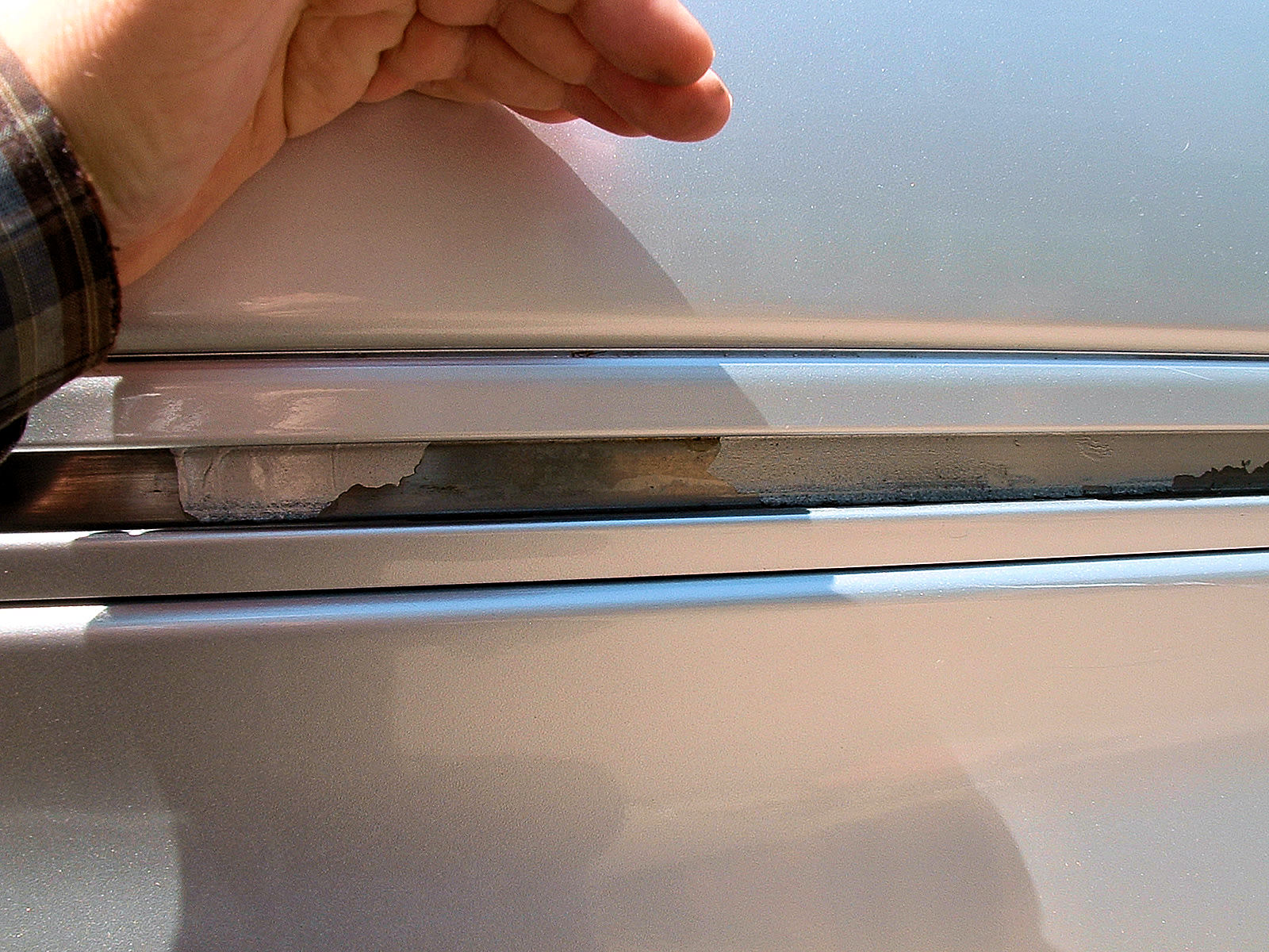

On a related aspect, I have a lot of paint peeling off the inside of the middle guide rail, noticed it this afternoon when cleaning the van and jetting out rubbish from the rail !
I've not noticed anybody asking about this before, if its common or not ?
It doesn't appear to be on the surfaces that the roller bears on (I don't think it presses on the back ?) so just a bit concerned as to why it is happening, looks like I'll have to get some paint in and start splashing it about :(

g8dhe wrote:On a related aspect, I have a lot of paint peeling off the inside of the middle guide rail, noticed it this afternoon when cleaning the van and jetting out rubbish from the rail !
I've not nipped out to check, but I don't think mine (or others I've seen) actually have any paint on the inside of the guide rail. Has someone painted yours specially in at attempt to make it good as though it matches the bodywork. If so I'd not be surprised if its coming off as its being hammered by moving rollers etc. (and sand etc!) I'd have thought :roll:

mikeonb4c wrote:Has someone painted yours specially in at attempt to make it good as though it matches the bodywork.
I must admit that had gone thru our minds, I'll be having another check today whilst the sun is out. But I can't say I had noticed a silver strip on the sides of dark coloured Bongo's (especially Black ones!) either, so they may well be painted in some way.

Right well after closer inspection with better lighting I think someone has done a quite good job of painting the whole interior of the rail - but without thought to the fact that the roller runs along the lower surface and has caused the paint to peel off, also there is only a single coat of paint no primer or anything.
Time I think to remove it all !

g8dhe wrote:Right well after closer inspection with better lighting I think someone has done a quite good job of painting the whole interior of the rail - but without thought to the fact that the roller runs along the lower surface and has caused the paint to peel off, also there is only a single coat of paint no primer or anything.
Definitely. Time to strip off and 'Celebrate the Slot' :shock: :oops: :lol: 8)

Post by g8dhe » Sun Jun 07, 2009 1:34 pm
Yes the faces and the rail itself all match up, its not been painted in-situ either, so I plan to jet off the paint in the slot but leave the outer trim being silver the slot hardly shows anyway.
