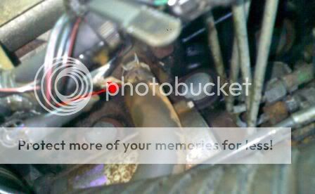

bought a bongo last week, had it serviced and looked over and everything seemed fine. I've managed a few short trips in it with no issues.
After the drive fromn portrush back to belfast today it started to leak. It didnt start leaking untill i parked it and turned the engine off - possibly a conicidence. I did notice that the temp needle did move about an eighth of an inch past center and then settle back down to an eighth of an inch just before centre - could this be a sticking thermostat and could this have added to the leak?
the leak is coming from a hose that enters the engin block underneath the drivers seat. The van is a 96 2.5 diesel and hasnt done many miles - 78k km - but i imagine that hoses perish.
any way - ill try and attach a photo.
? any help on posting an image would be good?
Hopefully this isnt to much of a problem, i've been recommended mazdabits in newtownards - any other recommendations would be good, i'm based in Holywood (N.Ireland)

i've added the photo - i think.
do you recon its drivable? i'd be probably ten mins drive to get to a garage, about a litre came out which ill fill again before i leave.

As long as the water didn't go low enough to empty the expansion tank, you should be OK - otherwise, it will need bleeding.

The pipe inserted into the block where the hose is attached rusted on mine. Both were replaced, the hose(silicone) abd the pipe(stainless steel).

OK, just checked and the header tank is dry (the tank under the bonnet?) it was full this morning. I guess i'll nedd to bleed it :(

Do not drive it till you have refilled it and BLED it...Unless the garage is experienced in Bongo's there is a good chance they will not do it right.

Factsheet in the members area on bleeding, get the hose & do it yourself it's easy to do the hose itself, make sure you flush the system thoroughly. Personally, wouldn't recommending driving it with a shot hose, full coolant loss can be catastrophic.
