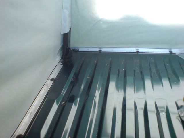

heres the quick way:-
Aerial is £9.99 ( maplins)and works with my LCD TV but my TV is rear mounted above side kitchen unit
note
I've since removed the mag mount magnet and drilled and fitted direct into the rear spoiler
you have to be careful you can open the rear door and roof together without smashing the aerial! ( so its bolted at the rear of the spoiler
heres where you get into the roof void , via the rear wash wipe hole
hope that helps
