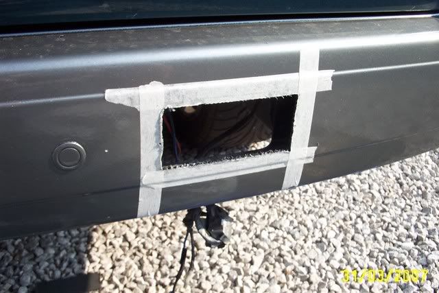

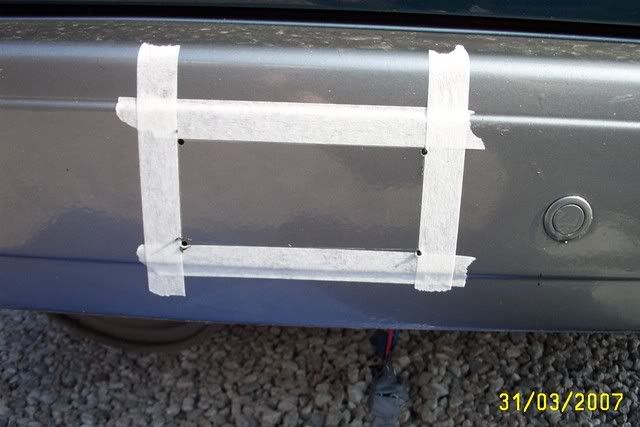

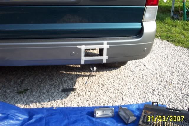

First off.... mask the area you want to fit the flush foggy(ies) Check behind the bumper first for the strengthening columns.
Then i drilled a hole in each corner, when i was happy all was level and true...
And colour coded the surrounds of course....
Then, the hole can be cut using a conventional jigsaw,slow and carefully....
Please remember to cut the hole to size for the INNER part of the lamp...the shroud has to fit OVER the bumper....
No more snapped off danglies! :shock:

If you don't have a jigsaw you can drill small holes all around the masked area, open out with a small round file, then tidy with a flat b******. (Proper file, honest.)

As long as you use a new blade, you can cut a very clean quick hole using a stanley knife - this time of year I warm the area with a hairdrier (well hot air gun :roll: ) - mark ou the line and push the blade all the way through. Then apply gentle pressure along the line.
This method works very well, but if you try to cut with the tip only then the blade can slip and cause a nasty cut (to bumper or hand :wink: ).

When I did mine I stitch drilled all around the opening. It provided good insurance against the cutting device wandering off line. As madmile says, the plastic yields surprisingly easily to a Stanley knife blade, so you could us that with a wiggling action and side pressure without much danger of slipping. You can also abuse your drill :shock: by using it as a crude router with sideways pressure so that it breaks through to each stitch drilled hole - the bumper plastic yields well to that approach too. Then, as Bob says, a flat file will finish off the opening quite nicely although it is not essential as the foglamp cover plates hide all that stuff anyway. But stitch drilling is the key as it prevent you wandering badly off line. 8)
