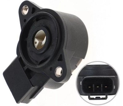

The TPS is a potentiometer which feeds back to the ECU the the throttle position see 18-9101;
https://www.lushprojects.com/bongoparts ... no=.html#5
There is a separate Air Adjusting Screw but accessed from the drivers side as I recall at the back of the engine.

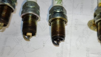

So, I cleaned this valve, which is an idle adjustment screw,
I cleaned the Throttle Body, even if it wasn't any dirty.
I also replaced the 6 sparking plugs.
And there's no change at all. Exactly as before. Same problems and same fault codes.
I will, as I planned in the first place, replace the MAF sensor, as I think it may be a good culprit.
I would replace or at least remove check and clean the TPS too.
And I'll see what happen next.
When I replaced the sparking plugs, there was one that was noticeably darker than the 5 others. So I suspect this too for the lack of power, but I don't see how it could affect the high fuel consumption. The wire looks ok. But I may check the distributor too and see what's inside.
