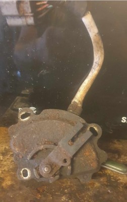

Hiya, so, reconditioned gear box fitted to the van (did not fix it) there's a gear selector piece which fits to the gearbox, that was done on Thursday 26th, so far so good but it's still early days.
That piece has been changed.

so your gear selector was faulty or the actual gear box had issues?
Gavinstjohn
Apprentice Bongonaut
Posts: 7
Joined: Tue May 21, 2024 4:39 pm
Re: Stuck in gear, fans on, no glow plug light.
Post by Gavinstjohn » Mon Sep 30, 2024 8:19 pm
At the moment it's looking like the gear selector.
sabbir
Posts: 6
Joined: Mon Sep 23, 2024 6:54 am
Post by sabbir » Tue Oct 01, 2024 5:27 am
it fixed your glow light and fan ?
Gavinstjohn
Posts: 7
Post by Gavinstjohn » Tue Oct 01, 2024 7:28 am
Hi, at the moment yes, the fault was sparadic, the van could work for a few days and then not. As it's only been a few days i don't know if the part swop has cured thr problem yet.
