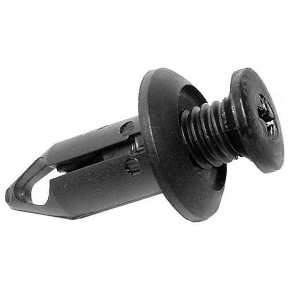

The lower fixings are SCRIVITS - Screw Rivets - lots of them are used in all vehicles, they have a thread for undoing them, but the thread is built into a plastic spring mechanism such that to install you merely press the cap down it expands the springing section and then it locks onto the threaded element when its fully inserted, ready for removal.
