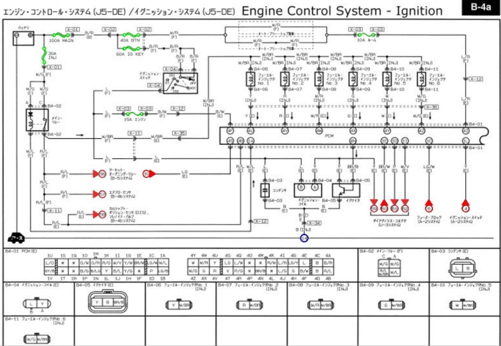

Having trouble getting my 2001 V6 AFT fixed after it lost power and won't turn over. No power/signal getting to the spark plugs. Does anyone have a wiring diagram from the ECU? There is an "amplifier" between the ignition and spark plugs that may be the problem according to the garage... All ideas welcome

If you have the normal distributor system then the diagram below relates;

Thanks Geoff, I’ve sent on to the garage.
Do you know what the component is the “amplifier” component is that I mentioned?
Also, they’ve hypothesized that it could be the crank position sensor that’s causing it not to start. Any clue on the likely hood of that?
Appreciate the help.
Mike

Yes the Crank position sensor is a quite common failure spares available on ebay.
The Igniter is the transistor that switches the current on/off, this current is then "amplified" in the coil/transformer which creates the spark to be sent to the distributor
