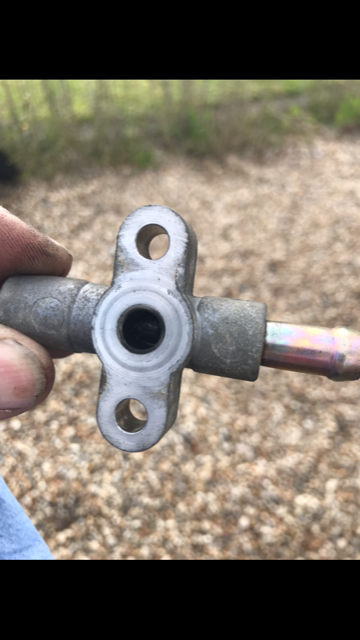

Pictures of Throttle body before & after.
There was a lot of carbon build up around the intake and butterfly valve.
This was thoroughly cleaned without removing the dark grey paint substance that is supposed to be there.
The butterfly now operates smoothly.
I also removed the adjustable valve on top of the plenum chamber.
I think this might be the air inlet to the plenum chamber for the idle.
There was a previous thread that directed me to the throttle body and this valve.
Both appear to have never been cleaned in 23 years.
With these back on and testing of the Throttle Position Sensor plus a little tweak of the idle speed, the Bongo now idles really nice and allows all gears to be selected when stationary and when warm. (Apart from L which stalls when warm)
