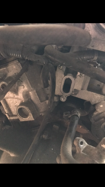

Also on the 1st photo there is a random hose with a u bend on the end that comes from the gearbox.
Is this supposed to be attached to anything? Or is it just a vent?

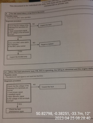

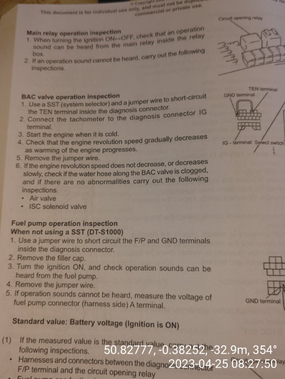

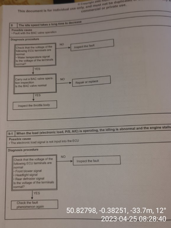

I had a similar problem, turned out to be the BAC (Bypass Air Conditioner) valve right at the back of the engine. The valve is a bi-metallic type strip that controls the air flow using the coolant temperature, it worked fine when the engine was cold/cool but started to stall once the engine had been running awhile! Turned out that one of the coolant pipes had been squashed flat and there was no coolant/wrong amount flowing and hence the valve wasn't operating correctly according to engine temperature. It is in a right difficult position right at the back of the engine and not easy to reach even with the engine cover back plate removed. If you have the engine manual details on page 196.
Just noticed in the faulting section that this also causes "The idle speed to take along time to decrease", which I think you noticed as well.

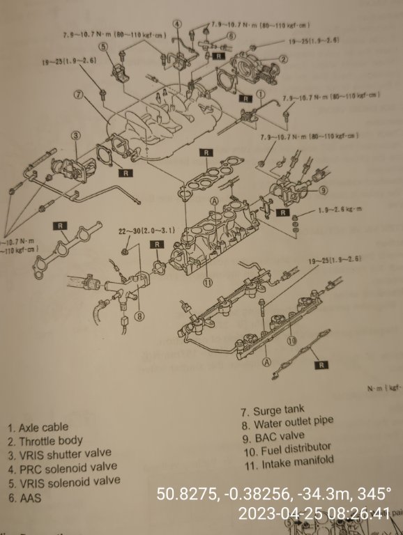

Here are some pictures from the manual, item 9 on the first diagram righthand side, middle'ish;

That’s the part I have removed and checked so hopefully I am on the right path.
There are 2 valves in the V6 version.
1 is controlled by the solenoid and the other I presume is controlled by the temperature of the coolant?

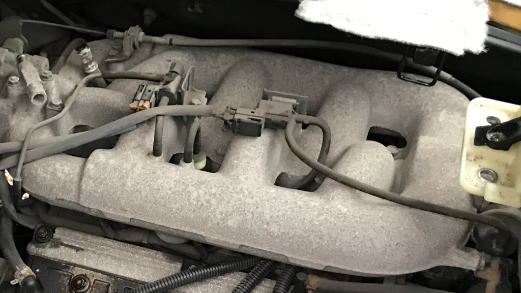

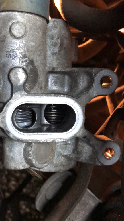

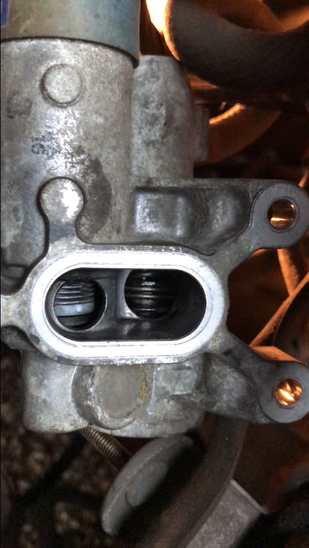

Does this look right?
The front solenoid looks like it was set up wrong.
The vacuum pipe and the pipe to the actuator are both on the same connector. Surely this bypasses the solenoid and would constantly open the actuator?

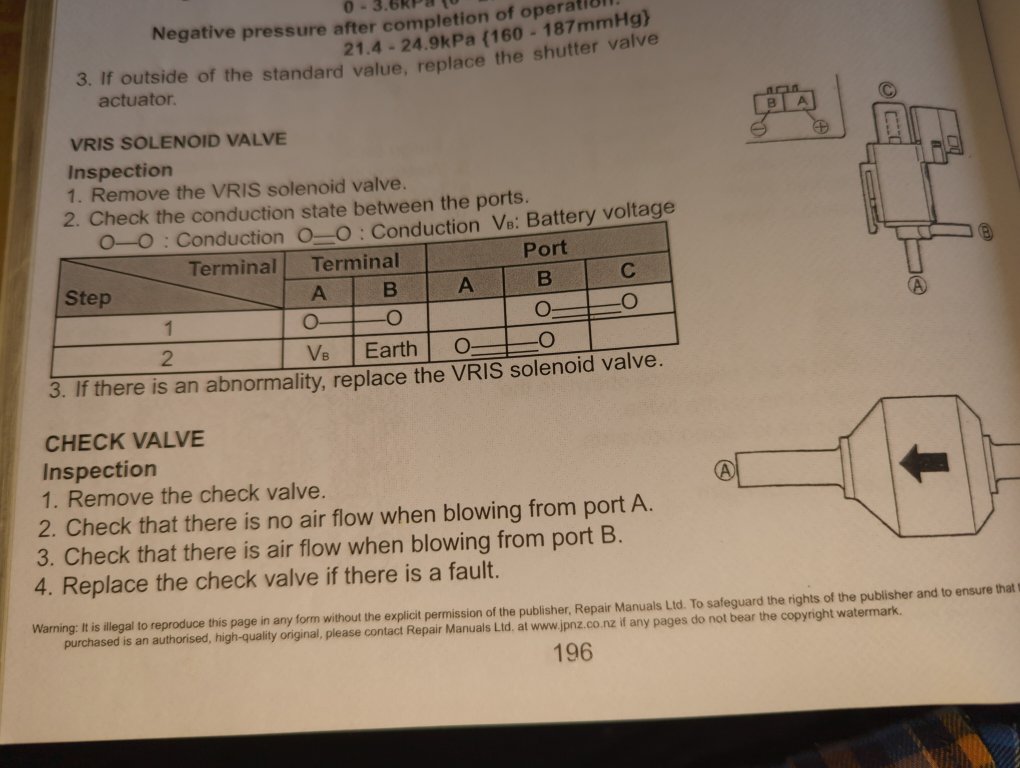

There are often three pipes, one a continuation of the vacuum feed and the other on the other side of the valve itself. Actual arrangement varies depending on the valve see images below and instructions for testing the VRIS Solenoid valve;

What I meant is that the right one is currently set up so there is a constant vacuum to the actuator as the pipes are connected and the valve would not make any difference.
The one on the left is correct but the solenoid is stuck open.
So both actuators are being opened when they should both be shut until the solenoids are switched on
Posts: 10883
Re: Engine stalls when warm
Post by g8dhe » Sun Apr 30, 2023 11:58 am
I can't tell from here, some of the solenoids are change over and not sure which combination is used for what.
