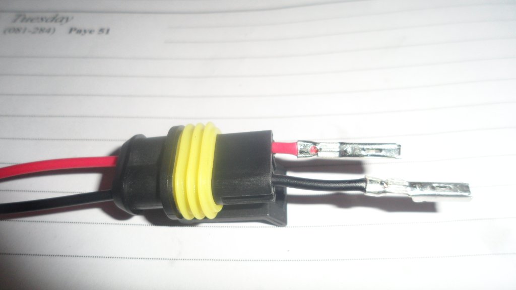

ABS alternative sensor. first assemble you're parts 1, Daewoo Lanos (1997-) Nubria (1997-05) ABS wheel sensor left or right not important as you will be cutting off the metal bracket . E-Bay item 334132988683 price £5.43.download/file.php?mode=view&id=881

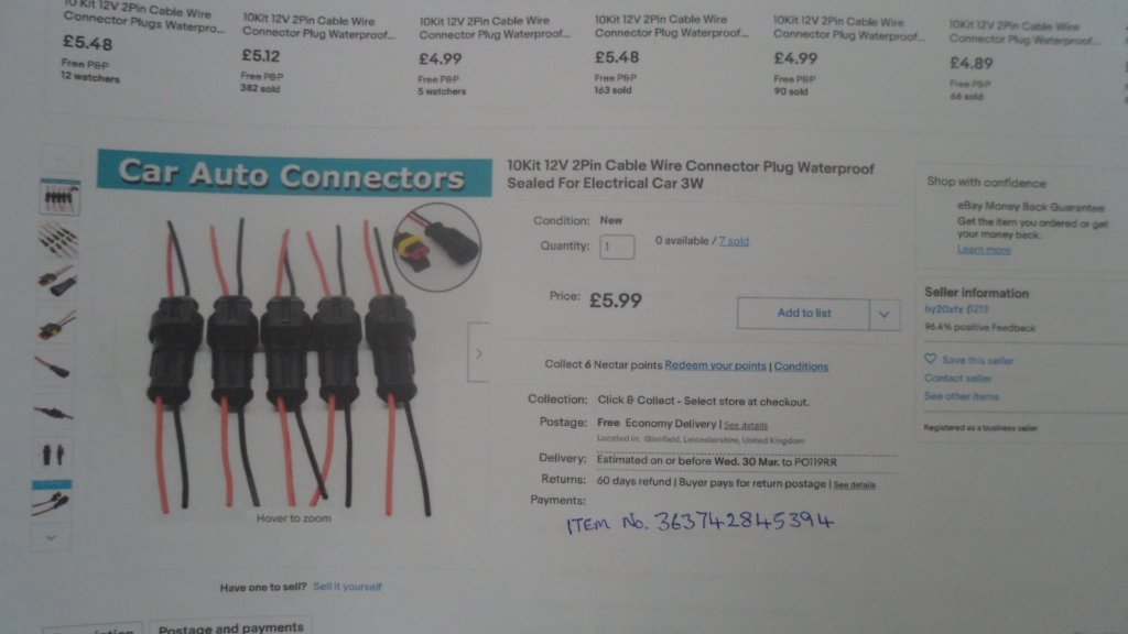

2, 12v 2Pin cable wire connector plug E-Bay item 363742845394 £5.99 for 5.
Take the sensor and carefully cut off the metal bracket taking care not to cut the plastic sensor.Image

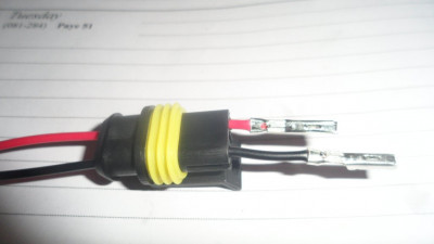

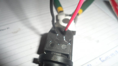

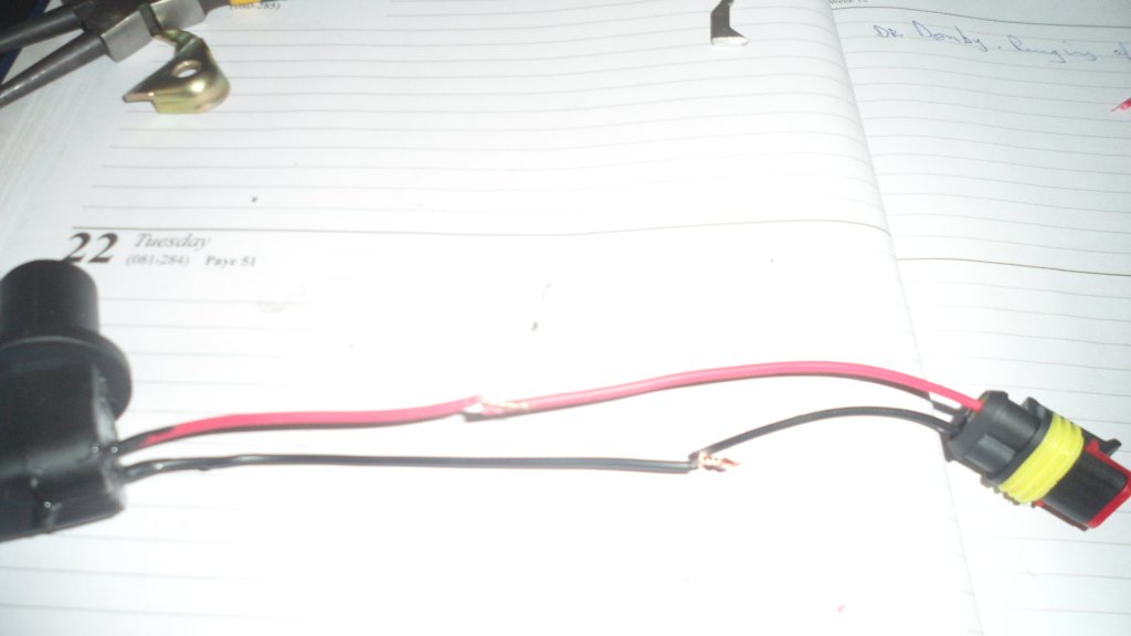

take the male part of the cable connector and remove the red clip at the front of the plug exposing the contacts, then push the wires from the back and remove the contacts with the wires attached out of the plug. throw away the plug , attach the wires and contacts to the sensor . Image Bond the connectors and wires to the sensor with JB weld - set aside to cure (overnight).Image

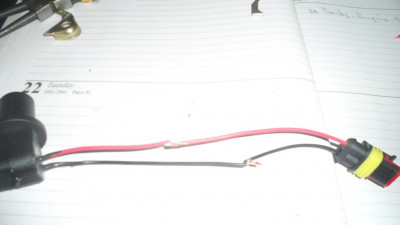

this can be disregarded if you can get you're hands on a daewoo abs sensor plug ( good luck with that one). Take another plug wire connector and solder the wires to the ones from the sensor now you have a sensor connected to a plug .Image

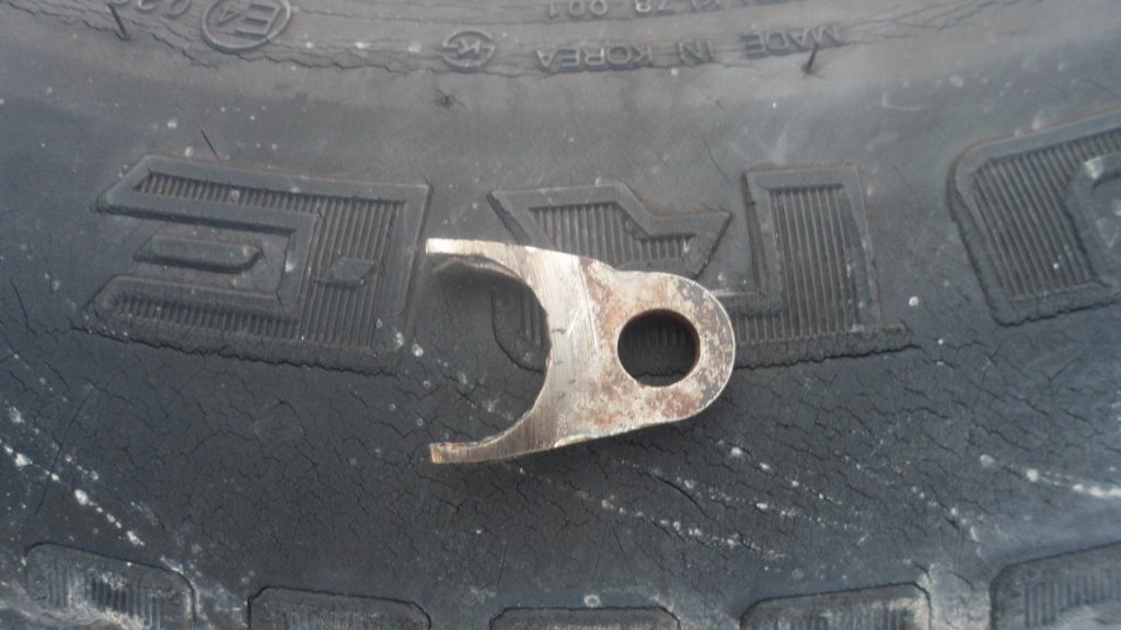

Remove you're original sensor be careful not to shear off the retaining bolt , cut the wire to the original sensor close to the sensor ,the sensor will be destroyed during removal from the original sensor you will need to retain the metal bracket as this will attach the new sensor . cut the old bracket across the large hole replicating the bracket you cut off the daewoo sensor.Image put a 1.5mm washer onto the daewoo sensor and fit into original location useing the original cut down bracket you may have to clean the sensor location hole with a file or sandpaper . fit the socket end of the connector to the original wiring solder and heat shrink and you are done.Image

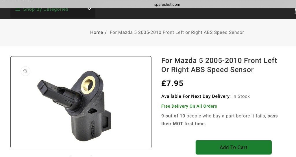

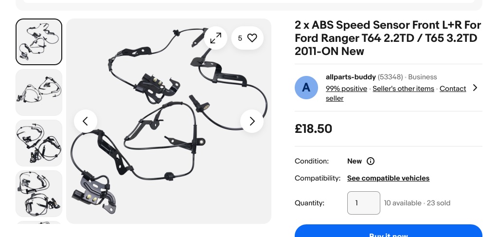

I’m going to replace both my front ABS sensors as the warning light appeared and they’re showing as faulty on the blink test, codes 11 and 12.
Any updates on suitable replacements.?
Scanning the tinterweb I’ve seen a couple that might be useable alternatives to the Daewoo suggested.
The ones I saw that may work include a Ford Ranger part, and also a replacement of only the sensor itself.
Obviously there’ll be some re-wiring involved whichever I get.
Just wondering if anyone had done theirs lately and had success with any other sensors.??
Bongolian
Posts: 120
Re: Abs sensor alternative
Post by Bongolian » Mon Jul 28, 2025 2:29 pm

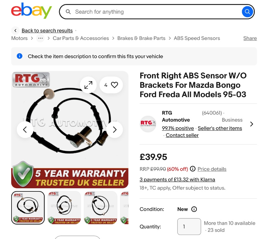

These are significantly cheaper and come with all brackets required..

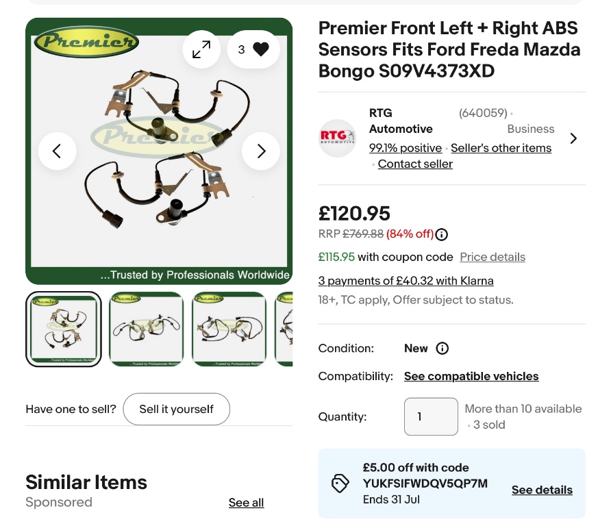

Alternatively, without brackets but with no need to mess with any wiring, these look suitable too.
Bongolian
Posts: 120
Post by Bongolian » Mon Jul 28, 2025 2:34 pm
Any Bongoers out there used either, or the supplier.?
