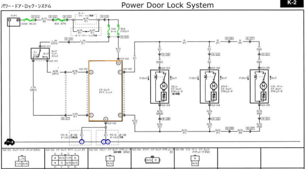

Post by g8dhe » Tue Jul 13, 2010 3:32 pm
Here are the guts of it;

Posts: 10916
Re: Original Mazda remote central locking system
Post by g8dhe » Sun Feb 27, 2022 5:18 pm
That sounds like you might have a broken wire on the original central locking switch, a common problem normally at the drivers door hinge.
On the door switch itself there is a Blue/Red which is power to the switch, then two wires one for open one for close ,Yellow/Red and White/Black these feed the signal back to the control module down behind the glove box, normal problem is one of the wires has broken and hence won't send the release signal to the control module.
If you have a meter check to see if the switch is sending the signal in the door itself and then check that wire all the way back down to the control module, most likely a break possibly in the door hinge section when you were running the other wires.
