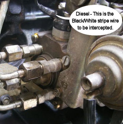

Posts: 10884
Re: Fuel shut off Solenoid
Post by g8dhe » Tue Aug 31, 2021 11:16 am
The wire is the feed to the fuel cut-off valve
