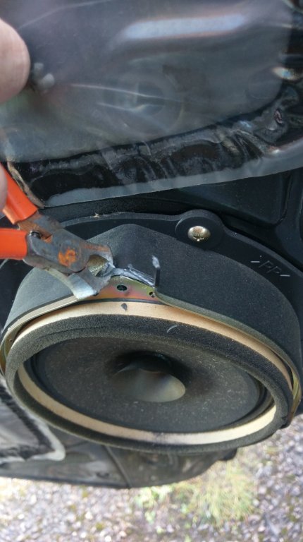

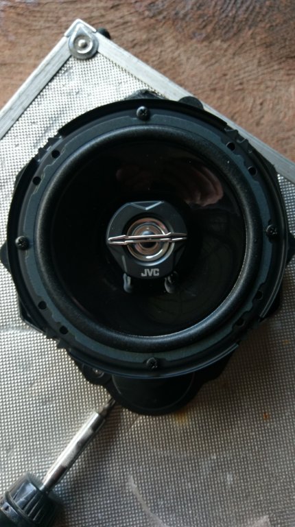

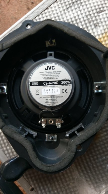

These JVC CS J620X speakers will fit straight in using the original mounts, just trim the plastic around the speaker, remove the screws and pull the speaker off. Trim it flat and fit the new speakers. They are pretty good speakers and only £20

Them JVC speakers is what I used, I got creative when fitting them.
A recommendation after fitting them would be to use some spongy stuff around the front end to create a seal with the door panel otherwise the bass is horrendous.

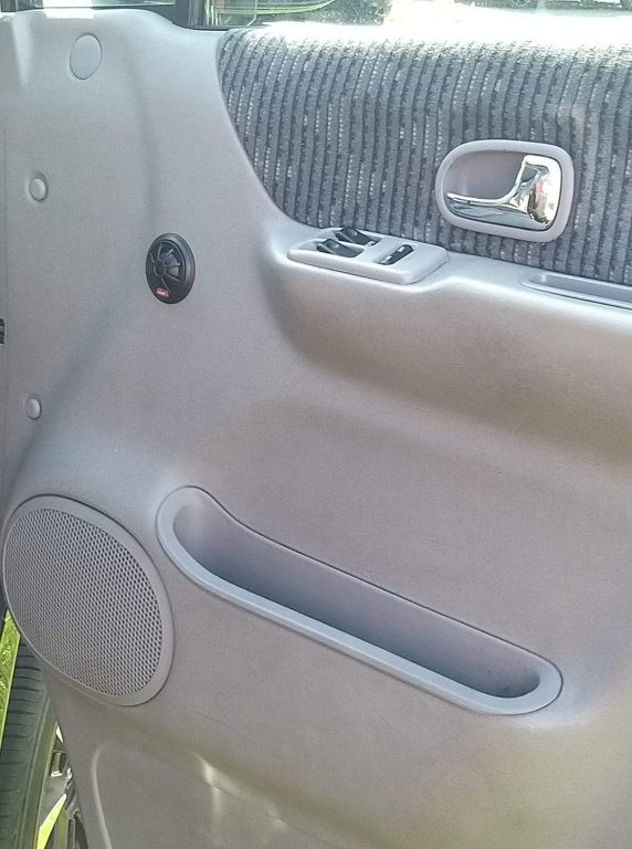

Whilst I was tracking down a rattle in the passenger door (see another post) I decided to check out the ‘dead’ speaker and get a feel for the fitting of replacements as per above.  Removed the speaker and noticed one of the spade terminals had simply come off the lug.  Plugged back on and we now have music again on that side of the Bongo.  I do like cheap fixes. (Don’t think the rear arches will be cheap
Long term I’ll likely update the speakers but only when properly broken. Thanks for the above posts.

In addition, if those are the original Mazda speakers in the photo with the cutting tool, mine are quite different.  Could be they’d been replace back in Japan before she arrived in UK.  Anyway, let the head banging resume....
